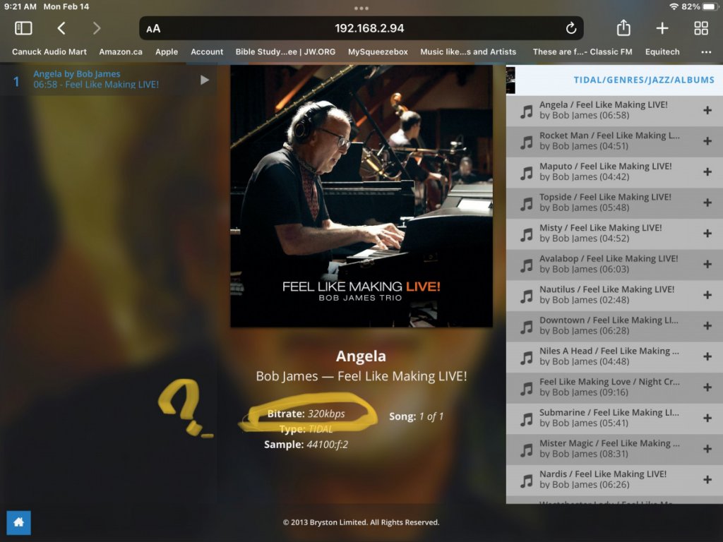

SoundGame
Re: Announcing The Bryston BR-20 Preamp/DAC/Streamer
« Reply #426 on: 14 Feb 2022, 03:14 pm »
Chris,
Acknowledging your comment below about resolution from TIDAL, I've seen it stated in a number of cases that the BR20 will do 16-b/44.1kHz from TIDAL however, though I do see a Sample Rate = 44.1 the highest bitrate on any file I get from TIDAL is showing as 320 kbps - is this in fact 16-bit or am I hearing an upsampling done by the BR20?  Very curious as to the reason for limitation on any TIDAL file to 320kbps???  :scratch: :duh:
44khz 16bit is the highest lossless resolution provided by TIDAL and we don't support the lossy MQA format.
Chris

SoundGame
« Reply #428 on: 14 Feb 2022, 04:59 pm »
Thanks James,
I've made this change i.e. from High to Lossless but what I'm seeing now if very curious.  Playing this same track, I have:
A variable Bitrate that is fluctuating as the track plays....ranging from about 500kbps and going up as high as 1000kbps;
While the Sample Rate is: 44100:16:2
I guess its the Sample Rate that is now 44.1 kHz /16.2-bit that indicates I'm now getting CD quality.  Good to be reassured...now to listen some more to this player vs. the Bluesound NODE (v3)
Make sure in "Settings" you have it set to Lossless.
James Tanner
  • Posts: 21005
  • The Demo is Everything!
    • http://www.bryston.com
« Reply #429 on: 14 Feb 2022, 06:10 pm »
Hi - Yes the bitrate will change as it streams.
james
