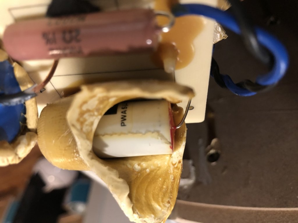

 :lol: :lol: :lol:  Let's peak under the hood at the crossovers inside.

Ouch, That ain't pretty
Danny
When do you create an Upgrade Kit for this one ?
GR LS 50 Meta Virtual OB Line, sounds like a large audience.

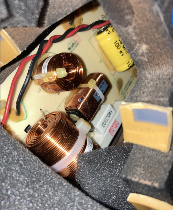

Just wanted to share this because this thread popped back in to my mind yesterday.
I had the meta now for some days and really liked them compared to the old LS50 which were kind  harsh I felt in the upper ranges.
Regarding the crossover: these are definately different. Also spaced out on two plastic boards. this is the lower board.
Wigand
  • Posts: 64
Re: LS 50 Meta open baffle like sound
« Reply #8 on: 4 Jan 2022, 06:08 pm »
Also all the Values are on the components. So I think one could easily replace them.
But I wonder if its even worth upgrading due to how limited the space is...

« Reply #9 on: 4 Jan 2022, 07:06 pm »
There is a LOT of room for improvement with that.

Because I also noticed that the binding post have CHUNKS of metal on them. Basically I really like the voicing of the speaker.
You think just changing the components to all air core, mills and quality caps makes a difference worth making that change?

If it's anything like the R11 we looked at recently, there's probably a lot of bracing in the cabinet that will make it tough to upgrade anything but the caps and resistors..
But tbh, even buget level Solen caps and Lynks resistors will definitely maintain the same voicing, but it will greatly improve overall clarity. Though the iron-core inductor will still hold things back a bit.
I would guess any fully upgraded crossover may need to be external.

The cabinet is really strong. Its 3/4 and it has like a cross bracing in the middle (so 4 compartments). So its really tight in there.
Yep.  Those inductors are really close to each other and they look like 18 or 20 gauge.  The capacitors and resistors are cheap.  If you put in some nicer components and space them properly, you will hear a massive difference.

https://www.audiosciencereview.com/forum/index.php?threads/kef-ls50-meta-review-speaker.25574/page-31#post-1037539
The topology of the crossover of the LS50 Meta is shown in figure 24. The smoother response of the new tweeter has resulted in fewer components in the HF filter and the remaining series capacitor (C1) is of higher quality.
The LF filter is similar to that in the original LS50, but includes an extra low-Q parallel resonance branch (C3-R3-L4) to compensate for the higher sensitivity in the
driver’s upper midrange due to its lower inductance.
The inductor L4 is the only one in the crossover to have a core. It is vital that only the resistor R3 controls the Q of the branch. To that end, the resistance of L4 (which is subject to change as it heats up when passing current) is kept as low as possible. As the core is a possible source of harmonic distortion if it nears saturation, measurements were taken to relate the current passing through L4 with that passing through L2. Figure 25 shows that it will be seen that the current passing through L4 is much lower and the chances of its core saturating are virtually nil, a fact borne out by the THD measurements of figure 23.
To minimise any coupling between inductors, the three in the LF filter are arranged orthogonally and the HF filter is on a separate board, placed well away from the LF filter.
