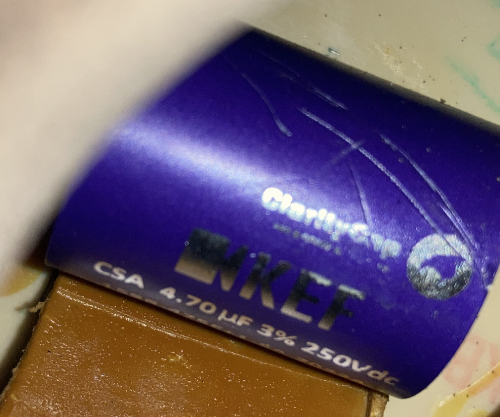

Found this pretty interesting; the cap on the Tw is actually a claritycap CSA 4,7uf
The two on the woofer are 18 and 30 elektrolytic. Theres definately some room.

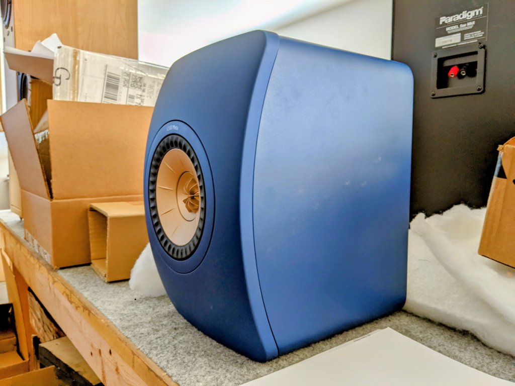

Reviving this thread cuz we just got a single LS50 Meta in a couple days ago. :thumb:
Should be interesting to see how it measure and what we end up doing with them. It'll be a little time before we can get to them since there are a few other speakers in front of it.
But It feels reallt solid, knocking on the cabinet shows almost no ringing.

Yeah, he is likely pretty short and sweet though. Were not going to upgrade them, they actually measure quite well, and are built like a tank.
Plus getting the crossovers out to swap out the electrolytic caps means permanent removal as they are glued to pegs. Plus it would require an external crossover if we did offer an upgrade for them. Just not practical.
