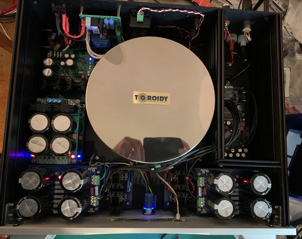

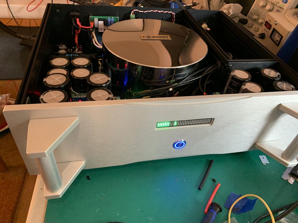

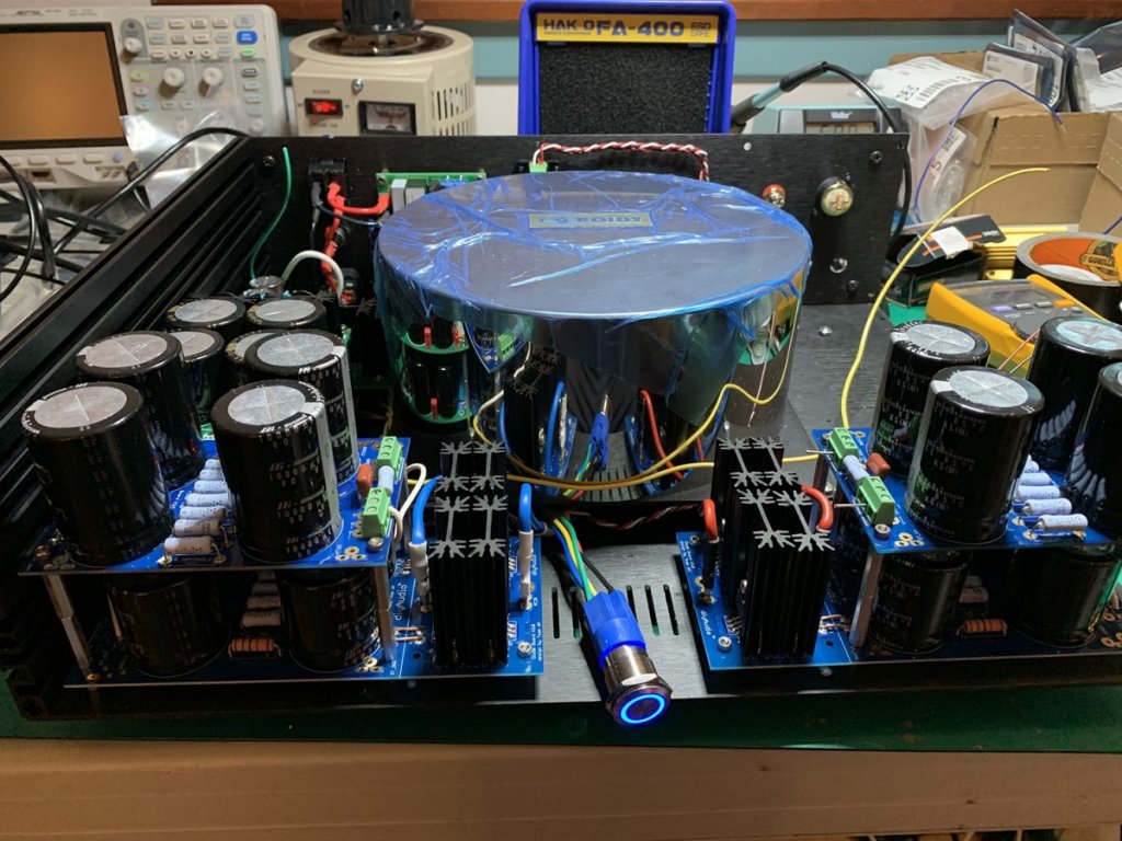

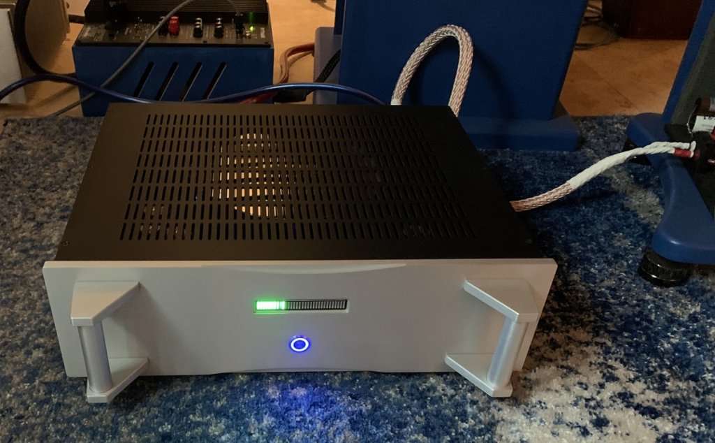

I finished (well, almost) my latest DIY amplifier build. This is another set of monoblocks - this time based on Bruno Putzeys' Purifi 1ET400A class D amplifier modules.
I tried class D a couple of years ago with the Nord NC500 monoblocks which use a Hypex module. I found the sound to be very clean and clear, but they sounded a bit thin and were not very engaging compared to my Krell FPB-300 (which they replaced after the Krell died after 20+ years) or my Parasound JC5 (which replaced the Nords).
But since I've really gotten into DIY in the past year or so, I decided to give class D another try. I have heard good things about the Purifi modules. I also decided to use a large linear power supply because many of the highly regarded commercial class D implementations take this approach, and because I could build it myself.
Each monoblock uses a 1500VA transformer with custom secondaries (Toroidy Supreme Audio model). There are several linear power supplies for the different voltage requirements. The high voltage rails (about 68V) have 134,000 uF in the capacitor banks in a CRCRC configuration. The low voltage supply which provides power for the input buffer and Purifi input circuits provides 20 volt rails with another 54,000 uF in the cap banks. This feeds a low-noise regulator on the input buffer to generate the required +/- 12V. Finally, one more regulated power supply generates the 15V gate drive (referenced to the negative high voltage rail).
An additional 12V power supply module is included to drive "accessories" which include the power light on the push button, a 32 segment LED power display on the front panel, and a delayed start circuit which allows the power supplies to reach steady state before asserting the AMP_ON signal to the Purifi modules. I have additional switches on the backpanel which can turn off the front panel lights when I don't want the distraction.
I am currently using the Neurochrome input buffer, but my plan is to experiment with other buffers over time.
The only thing that is remaining is to get an smoked acrylic panel which will fit into the front panel over the LED bargraph. The company that I have worked with in the past is moving, but should be able to make this for my in a couple weeks.
The first monoblock has been powered on for 3 weeks and has about 200 hours of music playing on it. The second one has only been on for a week and has probably 60 hours on it.  I expect it will take a few more weeks of playing before the amps are fully burned in, but I'm quite pleased with the sound so far. Very detailed with sweet sounding vocals - more engaging then the Nord amps I had in the past, but virtually everything in my system has changed since then. I'll report back after I've had a few more weeks on them.
