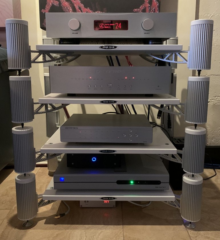

I finished my latest DIY project - a new preamp. I just got it hooked up to my main system with the NX-Oticas and I'm thrilled with the way it sounds. I think my Parasound JC-2BP will be listed for sale shortly.
The preamp uses a fully balanced Khozmo relay-based input selector and shunt attenuator. All shunt resistors are Takman REY. The series resistor and all signal path resistors are Vishay Z-foils. I'm using AMB Labs alpha 24 balanced line-stage buffers, with an AMB omega 22 supply, with 100VA transformer. A separate supply based on the AMB omega 11 is used for the digital logic, including the OLED display. The Khozmo includes a nice machined metal remote control.
I have two pairs of balanced outputs - one DC coupled directly to the alpha 24, and the other through a set of MiFlex KPCU copper caps which roll off the low end. I've got this latter output feeding my amps into the NX-Oticas, and the single-ended output from the alpha-24 feeds the servo subs.
All audio wiring uses DH Labs solid-core silver with teflon insulation and I'm using Viborg gold over copper XLR connectors.
I am new in this forum and I try to learn.
Which rack are you using?
Is that something special to minimize vibrations?
And in general: Many of the nice enclosures are also available in 19" width to be mounted in 19" racks. Is that a good idea - at least for someone who starts new and buys his first enclosures?

This is a Hybrid Standard rack from Solid-Tech. The corner posts are hollow aluminum and can be filled with sand (which I did) to provide damping and more mass. Each corner post is spiked and sits in a cup at the top of the post below to provide a mechanical path for vibration. The shelves are all adjustable with aluminum brackets holding MDF shelves. This rack is available in numerous configurations and colors, with different shelf materials including veneered wood, concrete and carbon fiber. It's very well made and relatively easy to put together (it took me the good part of a day including filling the individual corner posts with sand).
The wider Modushop enclosures have a front panel width just under 18". This is what I used for my preamp on the top of the rack. It's possible that they have rack-mount tabs available, which are designed to bolt onto a 19" wide rack. I haven't looked into it. Rack mounting is primarily used when you want to get the most equipment packed into the minimum space, and where you want to make sure the equipment can't fall out if the rack is jostled. It's generally not used for home audio installations, particularly if your equipment is in your listening room.
There are a lot of different home audio rack manufacturers. I think Solid-Tech makes some of the better ones, assuming you like the hitech-industrial styling. If you are looking for something in wood, check out Timbernation.

Jaytor did you find a source for knobs without position marks?

My original photo showed knobs I got from Parts Express. These are polished aluminum (but without position markers) and didn't match the brushed aluminum from the Modushop chassis very well. I found someone on AliExpress that had knobs (again with no position markers) that have a sand-blasted type finish that matched pretty well with the brushed aluminum. So that is what is shown in the photo I just uploaded. They took forever to ship though. They took a little more than 2 months to get. But they are pretty nice quality.

Thanks for the info about the Hybrid Standard rack from Solid-Tech.
I looked them up online and I found lots of details. I even found a price list here.
https://drive.google.com/drive/folders/12bYUjzS-Sg1P6Ft8E0h_YJ6PjZxqam6O
But it seems every nut and bolt is listed separately which makes it difficult to get an idea about the price of the whole thing.
Obviously I could ask a shop for a quotation. But maybe you can give me, and maybe others, an idea about the price.
When I look at their nuts and bolts price list and your rack then I guess your rack cost a couple of thousand USD, maybe even more than a thousand per floor level, correct?

The rack I have has (or had this past spring) a retail price of $2650. That's including the small floor cups which you wouldn't need on carpet. My dealer gave me a discount off this price.
