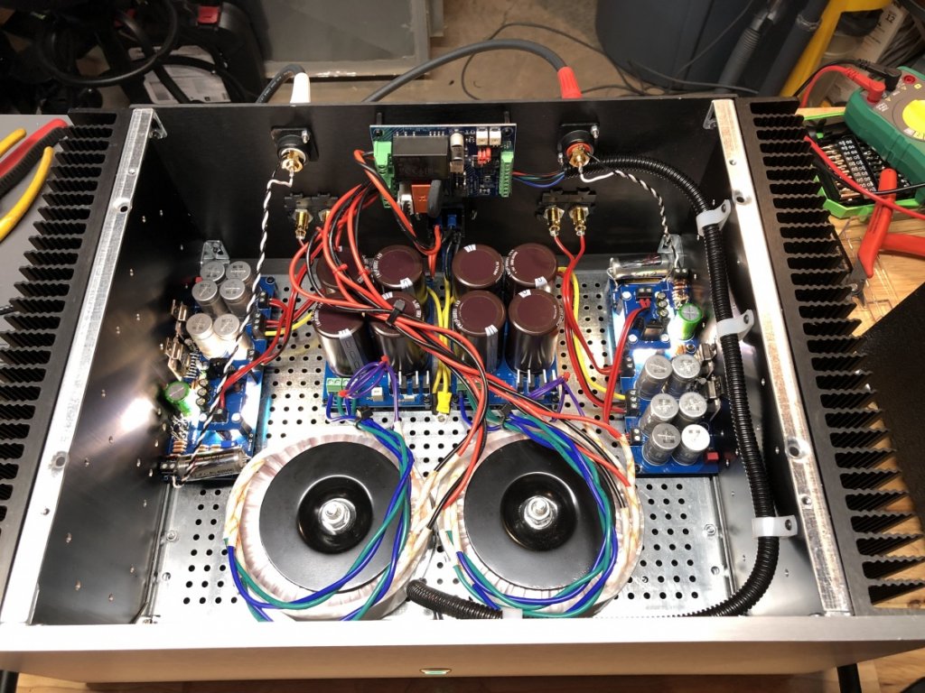

I finally got around to building a Folsom EC7293. I initially used a pair of cheap Kemet film caps for the input cap and it sounded good. I changed those out to VCAP ODAMs and now this amp sings.

Yeah, that is excellent work. I have one of those new, smaller soft start boards from Neurochrome that I plan on using for a preamp project. They are so much easier to fit into a chassis than those huge old ones lol.
Tom's ISS board is worth every penny. I will not build an amp without it. I will probably end up drilling out a hole for a trigger jack and use that feature of the board as well.

My Mod186 monos have been in my system for months, I am going to switch out for my Folsom for a while.
All I have to say after a week of break in is the Folsom amp is awesome.
