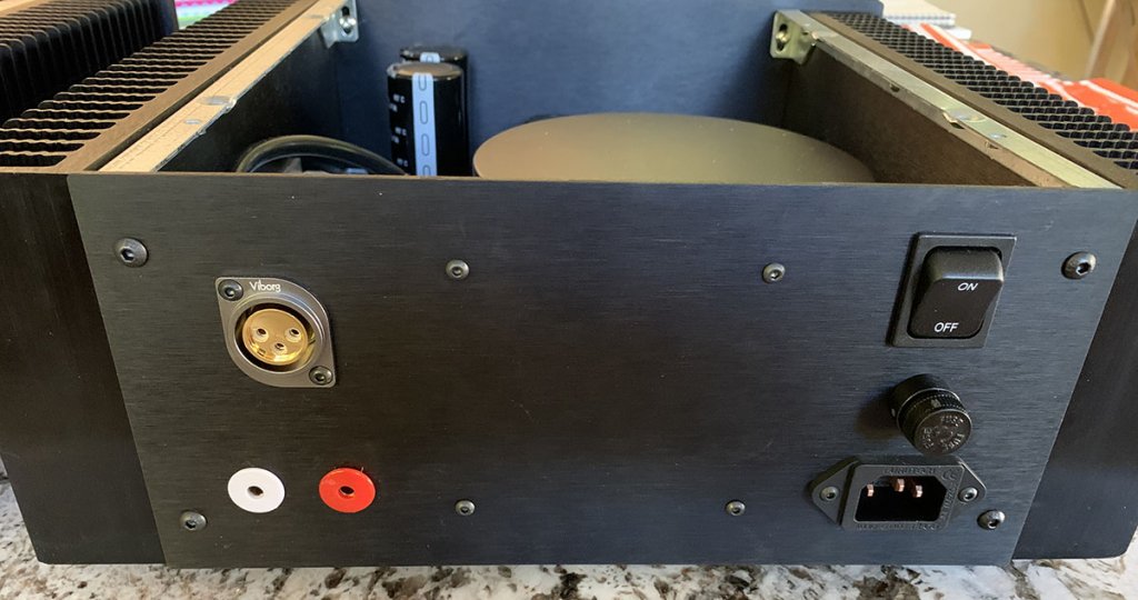

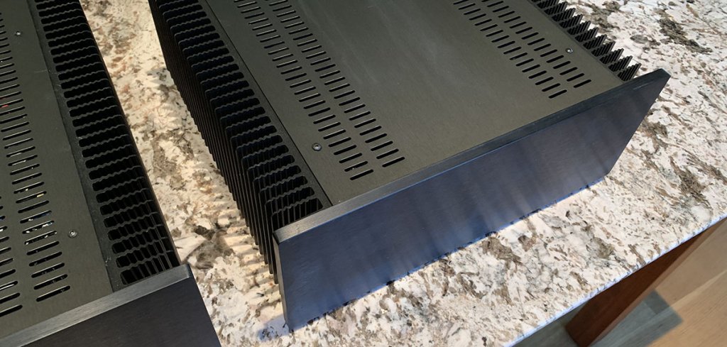

I've spent the last few months SLOWLY buidling a pair of monoblock amps to use with my NX-Oticas. I've only been able to work on these on the weekends, and I took my time since this is my first audio electronics build since about 1980. Back then, I built a Pass A-40 and a couple of my own designs until I got heavily involved in digital electronics and never had a chance to get back to audio stuff.
As my first (recent) foray into DIY electronics, I decided to build another amp based on one of Nelson's designs (I have fond memories of the A40). This is what is referred to as an F5 Turbo. It's based on the First Watt F5, but uses higher voltage rails (32v in my case), doubled output transistors, and a cascoded input stage. I also used a power supply with a capacitance multiplier to reduce ripple on the rails. There is also a soft start board under the power supply board, and thermal cutoffs mounted to each heatsink.
Output power is about 60W RMS into 8 ohms. I haven't finalized the bias yet, but I'll probably set the bias to around 1 Amp (which will give me class A to about 25W) to keep the amp running a little cooler. The NX-Oticas are fairly efficient, so this will keep me in class A almost all the time.
The power supply board for each channel has 72,000 microfarads of capacitance in a CRC arrangement, but most of the ripple reduction comes from an active Cap Mx circuit.  I used an Antek 400VA toroidal transformer for each monoblock.
The input circuitry has a switchable Jensen transformer for balanced input. There is also a switchable MiFlex copper cap for lower frequency roll-off since I'm using the powered OB servo subs. For outputs, I've got tube connectors in parallel with Cardas binding posts.
I haven't hooked these up to my NX-Otica's yet. I am running them in on a cheap pair of speakers first, to make sure that they are operating reliably. Once they've burned in for a couple weeks, I'll get them hooked up and let you know how they sound.
I'm currently using a Parasound JC-5, which is a pretty nice sounding amp, so it will be interesting to see how these compare. But I had a blast building these, so I'm sure there will be more DIY audio electronics in my future.

Well, after listening to my F5 Turbo monoblocks for a few weeks, I decided I wasn't really happy with them. They had good dynamics and no noise (hum or hiss), but just didn't have the clarity (detail and imaging) I was used to with my Parasound JC-5.
I suspect the quality of the components and/or wires I used was not good enough, and I didn't do an adequate job of component matching. The meters I had when I built these didn't provide any accuracy or precision when measuring small value resistors. I've since purchased a desktop multimeter which has much better precision.
At some point, I'll get around to rebuilding the front-end boards with better quality and matched components, and rewiring with higher quality signal wires to see if I can improve the SQ.

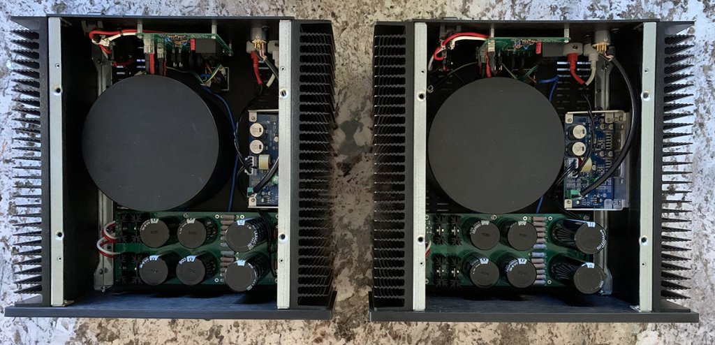

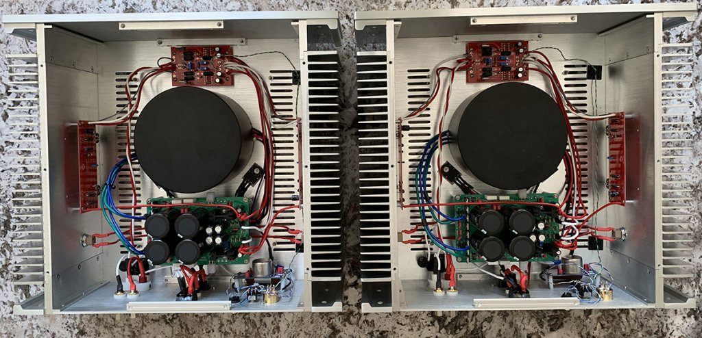

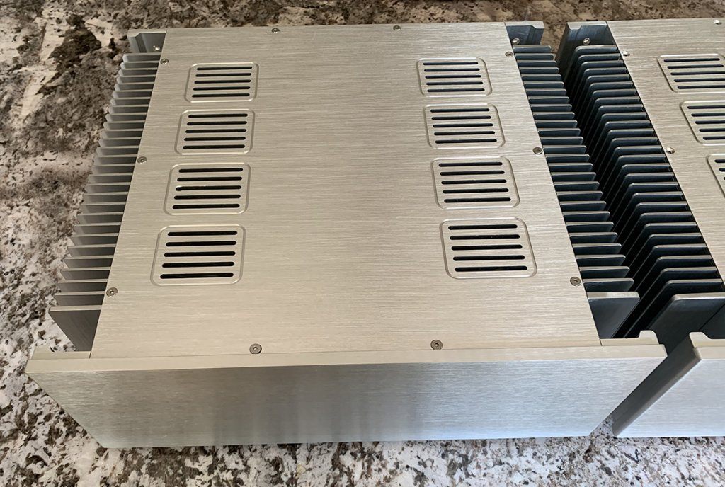

In the meantime, I built another pair of amplifiers based on the Neurochrome Mod-286 with a beefy power supply. These have plenty of power for the NX-Oticas and really sound fabulous. I'd say at least as good as the JC-5 and that's with lesser quality speaker cables. I've just ordered a speaker cable kit from Danny to make some short cables to use with these new amps.
Nice job!  That looks like a fun build.  Was it a kit or did you source all the individual components yourself?
Do you have a build thread for these on any forums?

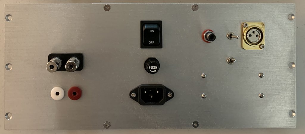

Thanks Rock Ball.
These weren't done from a complete kit, but the Modulus-286 amplifier module is sold assembled by Neurochrome.
https://neurochrome.com/products/modulus-286
The chassis is the 3U Mini-Dissipante from ModuShop available through the DIYAudio Store.
https://diyaudiostore.com/collections/chassis/products/mini-dissipante-3u?variant=12173317060
The soft start board is from XRKAudio, available through his Etsy shop. I used this in my FirstWatt F5Turbo as well.
https://www.etsy.com/listing/769363642/soft-as-a-feather-pillow-sfp-solid-state
I bought the power supply boards on Ebay - fairly cheap but fit in the case and provided what I needed. This is a CRC type design - two capacitor banks split by parallel resistors - which provides better ripple reduction than a single capacitor bank supply. I built mine with 2x15,000uF per rail in the first bank and a 22,000uF per rail in the second bank. The board doesn't include a snubber circuit to cancel transformer secondary resonances, so I added this to the back of the board.
https://www.ebay.com/itm/CRC-6-Capacitors-PASS-Amplifier-PSU-Power-Supply-Rectifier-Filter-Bare-PCB-Board/133283479788
All the parts for the soft-start board and power supply board are from Mouser.
The Transformer is the Antek AS-4225 (400VA, dual 25v secondaries). They also sell the steel cover for this transformer.
https://www.antekinc.com/as-4225-400va-25v-transformer/
The power supply is overkill for this amp. In fact, Tom Christiansen, the designer of the Modulus-286, recommends a supply a quarter this size. But I've generally found a larger supply provides better dynamics and fullness in the bass and lower-midrange. And since I don't have to worry about building to a budget, I went with the largest supply I could fit in the enclosure.
This was a fairly easy build because the amp modules are pre-built. The hardest part was getting the case together with the tight fit of all the components, but that was partly because I didn't realize that the mounting holes for the top and bottom covers aren't completely symmetrical and had already drilled the holes in the bottom plate before I figured it out. So the panels didn't go together quite as easily as they would have if I had not made this mistake.
I had Modushop cut the holes in the back panel - they do a great job for a very modest price. I drilled the holes in the bottom panel myself which was fairly easy. Overall, I'd estimate it took me about 30 hours to build the pair, but I like to take my time. This is a hobby, after all.
Next projects - finishing up a preamp for which I'm currently waiting for the case from Modushop which has a LOT more custom machining than these amps had, and then building another pair of monoblocks using the Pufifi 1ET400A class-D modules with a 1000VA linear power supply and a custom triode front-end. Oh, and a pair of Line Forces once Jay (captainhemo) gets the enclosures done for me.

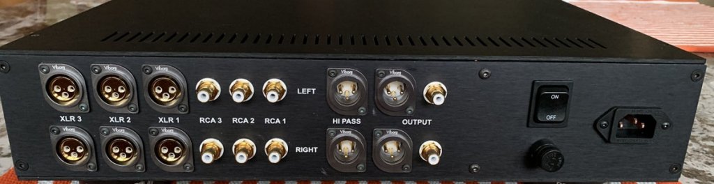

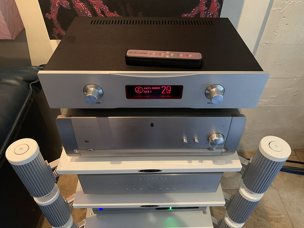

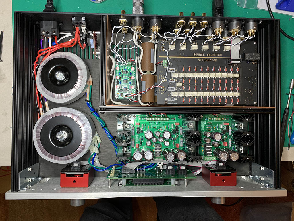

I finished my latest DIY project - a new preamp. I just got it hooked up to my main system with the NX-Oticas and I'm thrilled with the way it sounds. I think my Parasound JC-2BP will be listed for sale shortly.
The preamp uses a fully balanced Khozmo relay-based input selector and shunt attenuator. All shunt resistors are Takman REY. The series resistor and all signal path resistors are Vishay Z-foils. I'm using AMB Labs alpha 24 balanced line-stage buffers, with an AMB omega 22 supply, with 100VA transformer. A separate supply based on the AMB omega 11 is used for the digital logic, including the OLED display. The Khozmo includes a nice machined metal remote control.
I have two pairs of balanced outputs - one DC coupled directly to the alpha 24, and the other through a set of MiFlex KPCU copper caps which roll off the low end. I've got this latter output feeding my amps into the NX-Oticas, and the single-ended output from the alpha-24 feeds the servo subs.
All audio wiring uses DH Labs solid-core silver with teflon insulation and I'm using Viborg gold over copper XLR connectors.
