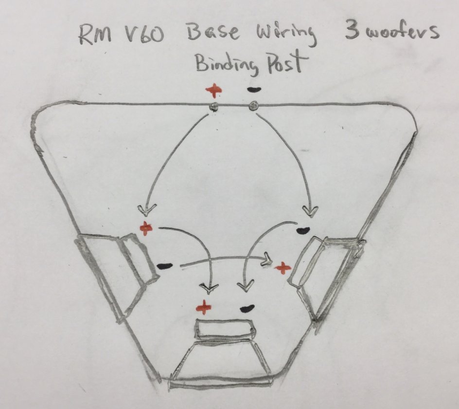

Hello Shaukat, what finish are your RM V60? Here is how the bass module is wired, 14ga. Analysis Plus was used. Good luck with assembling Ken

Zakski288
Thank you for the base connection. Any idea about the Midrange Neopanels?

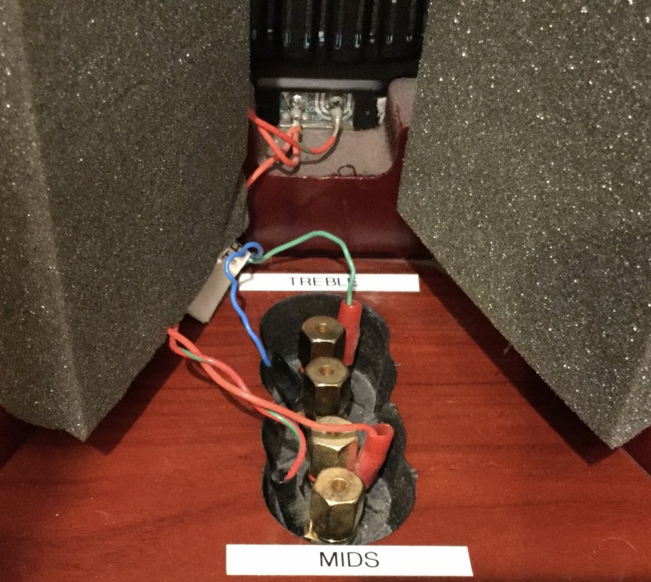

Here is how binding post are on top of base cabinets 1 1/2” holes, 3/4” apart , 1” deep. I think they were done with a hole saw. Ken
Housteau
Posts: 1119
Re: VMPS RM V60 question and Build
Reply #13 on:
18 Apr 2020, 10:26 pm »
Mine are flush.

Yes,
Ken's is quite elaborate
. For simplicity, I will drill 4 holes similar to Dave's.

Hello Shaukat, the top of base cabinet is 1 1/2” thick, you will still have to recess either the top or from the inside, most speaker binding post are only 1 1/2” long. Maybe you can find some longer ones. Ken
shauk786
Posts: 93
Reply #19 on:
19 Apr 2020, 10:31 pm »
Ken,
You are correct. It is hard to find any binding posts longer than 1.5 inches. Will need to recess the top inside the base cabinet around the posts location.
