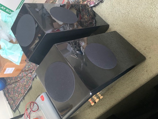

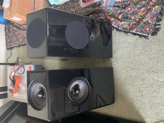

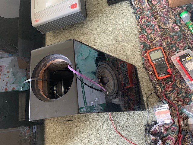

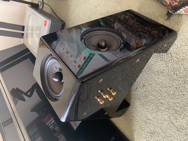

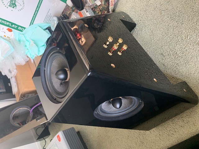

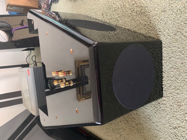

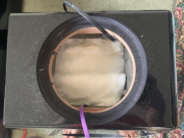

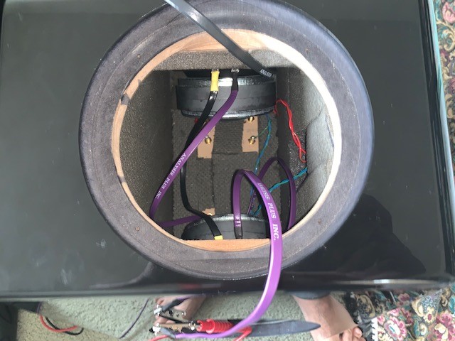

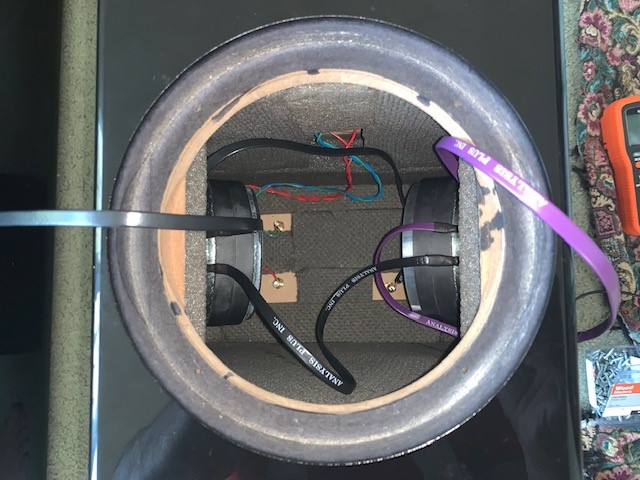

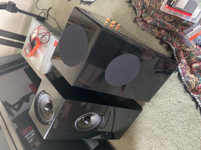

I finally received the 1/16th in thick gasket from Amazon. And it was the perfect size for the woofers in the bases and the grills are nicely flushed with the cabinet.
I have now completed both base cabinets
as illustrated by the pictures below:
Base 1
Base 2:
I have also measured the resistance at the base terminals and I am glad to report they are 4.1 ohms for both bases.
Now I am ready to tackle on the wings. I will update on progress.
Cheers.

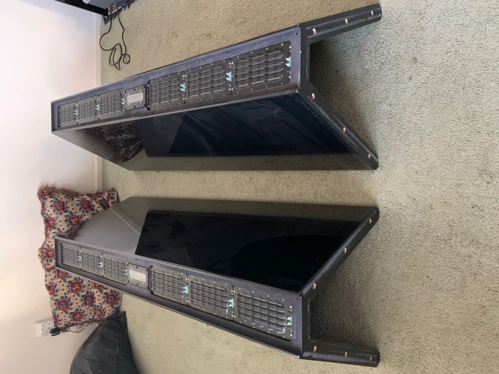

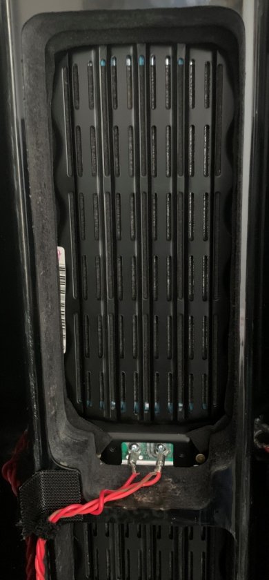

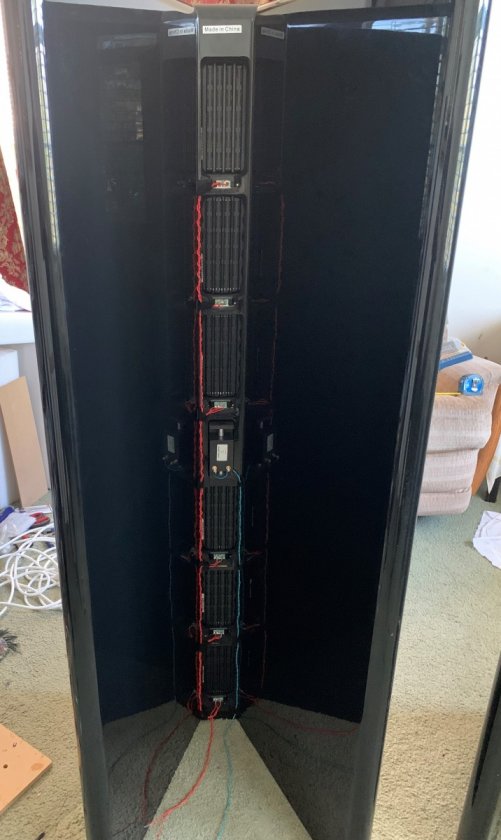

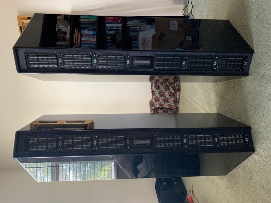

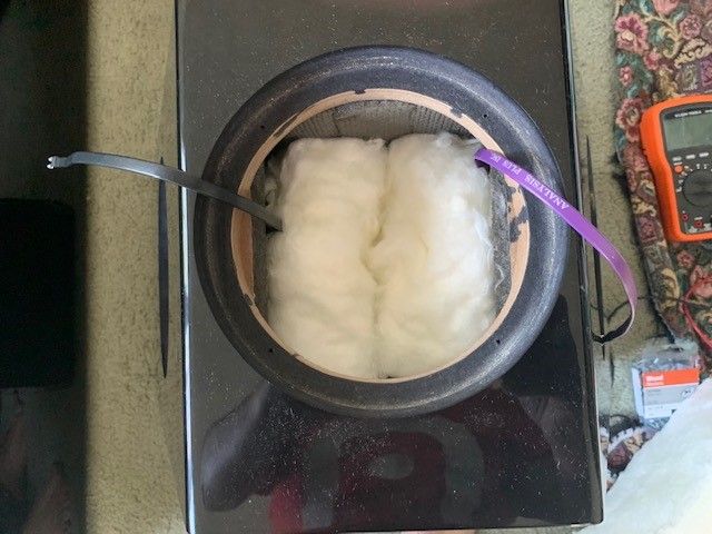

Today I started to work on the wings and I have completed installing the neos and tweeter onto the v60. I also used the same 1/16th thick foam gasket on the Neos.
Here is a couple of pictures:
Next step is to complete the wiring and I will start on the crossover build during the week-end.
Ken or Dave, on your v60s, how are the wires secured behind the wings? from the drivers to the binding posts on the base. glue or stuck behind the 4 by 1 inch foam?
Regards,
Shaukat
ZAKski288
Posts: 287
Re: VMPS RM V60 question and Build
Reply #42 on:
15 May 2020, 04:33 am »
Looks great. All the wires are ran through 3/8” holes in the thin section behind each panel, down the left side Two spots of hot glue.

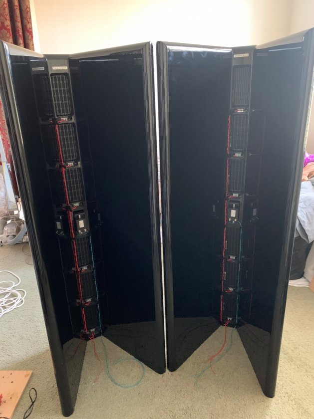

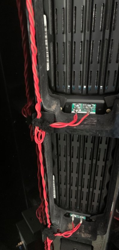

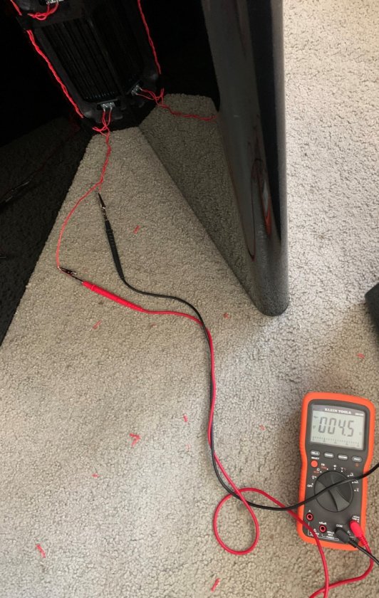

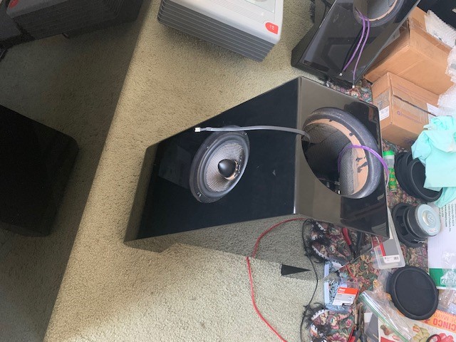

Today I was hoping to complete both wings but the Neos wiring for one wing took a lot longer than anticipated. Tomorrow will be more or less the same for the other wing. But I am glad I got some major progress going.
I decided not to drill any additional holes on the wings to secure the wires but instead got some heavy duty velcro and it worked perfectly.
Here are a few picts.
Taking measurement of the resistance, it seems dead on at around 4.5 - 4.6 Ohm
More to come ...

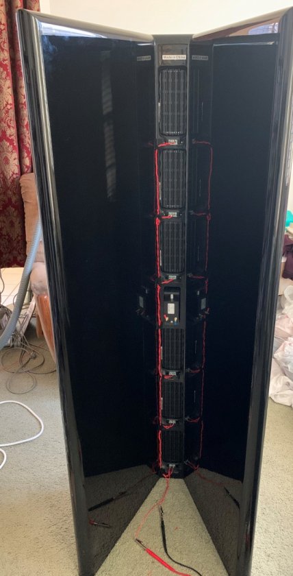

Today was as involved as yesterday tackling the other wing. Both are now fully wired for both Neos and tweeter. For simplicity's sake, I decided to run the treble wires on the right side while the mids are on the left.
The good news is that all the wires will be hidden from view when the 4 inches by 1 inch foam will be glued on the wings. I plan to do that last.
Here are the pictures:
The crossover build is next...
more to come

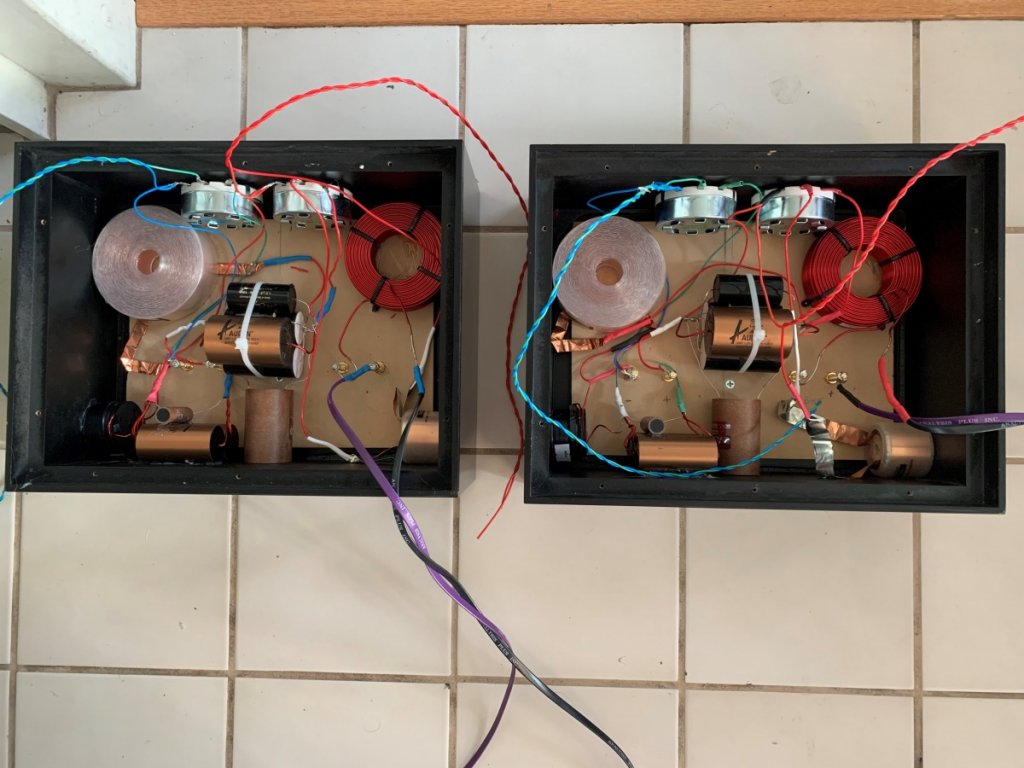

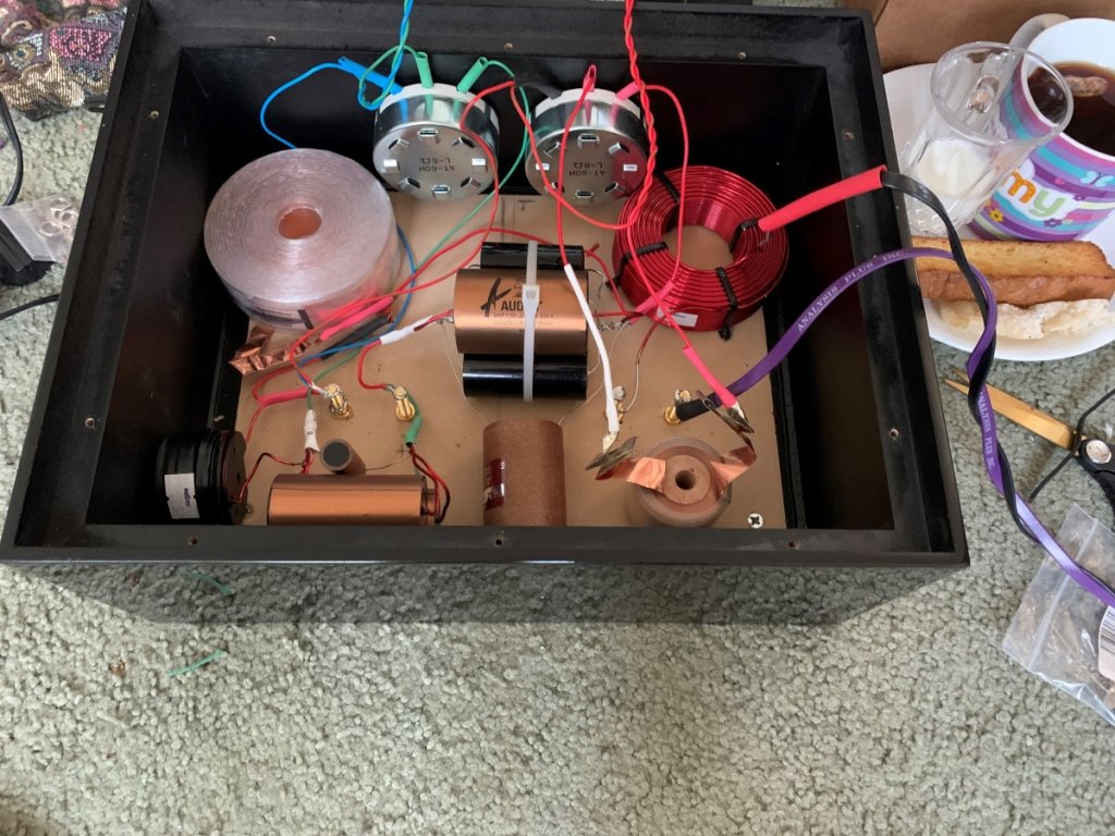

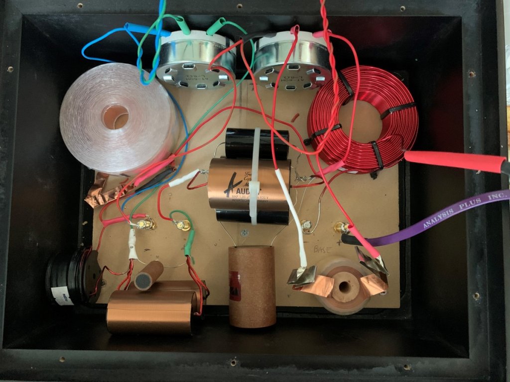

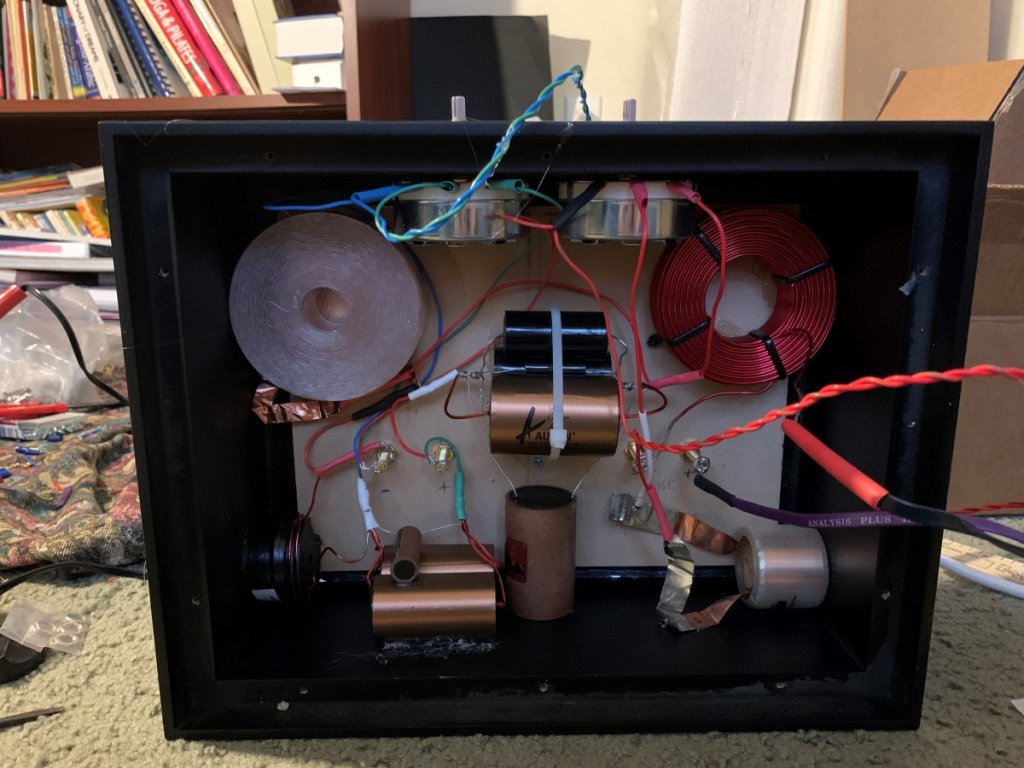

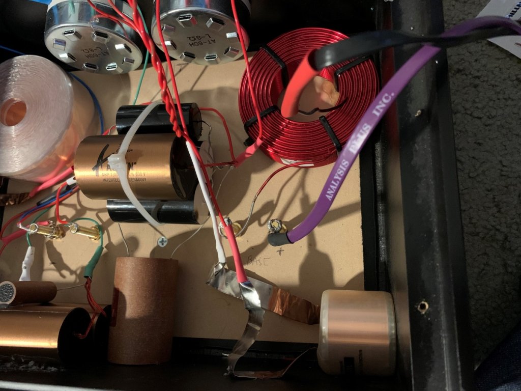

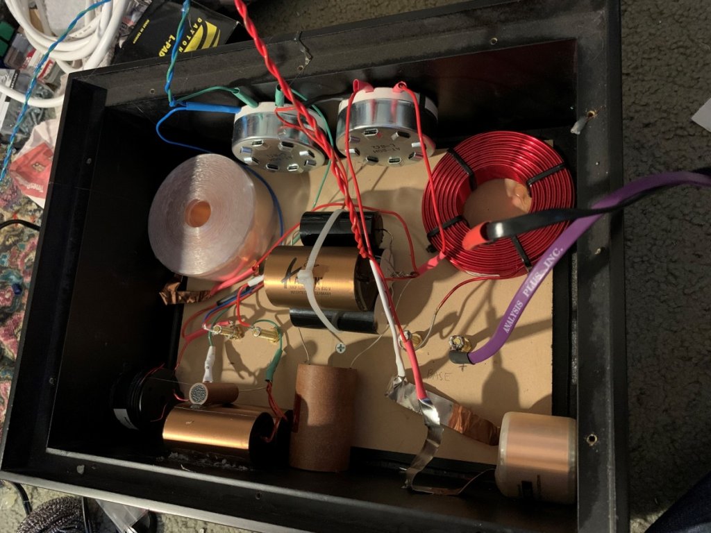

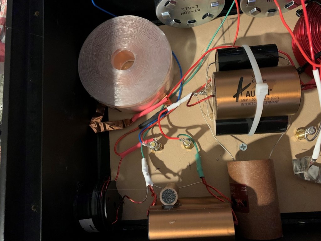

Wow, It's been 9 days since my last post here. Finally last week, my crossover parts arrived from Parts-express, Meniscus and Parts-connexion. I have decided not to go all out on crossover parts since I believe most of my listening will be through the active Xilica crossover. I was also taken by surprise when the parts came in, due to their sizes and was a bit concerned if they will all fit in the small v60 crossover box. After a few tries, I was able to fit them in.
This is how the crossover box is looking now:
As you can see from the pictures I decided to use all copper foil inductors (Goertz Alpha core and Jantzen ) for the midrange and air coils for the tweeter and base. All I got from Meniscus.
Midrange Capacitor bank:
Two 25uf dayton (Precision audio) (Parts-express)
One 1.0 uf dayton (Precision audio) (Parts express)
One 1.5 uf Mundorf Supreme (Parts Connexion)
One 1.0 uf Audyn True Copper Max (Parts Connexion)
One 1.0 uf Duelund RS (Parts Connexion)
Treble Capacitor bank:
Two 0.68 uf Audyn True Copper Max (Parts Connexion)
One 0.01 uf Duelund bypass
Ken or Dave,
Please let me know if I am missing anything here. Hopefully not.
Tomorrow I will start building the other crossover box.
Cheers.

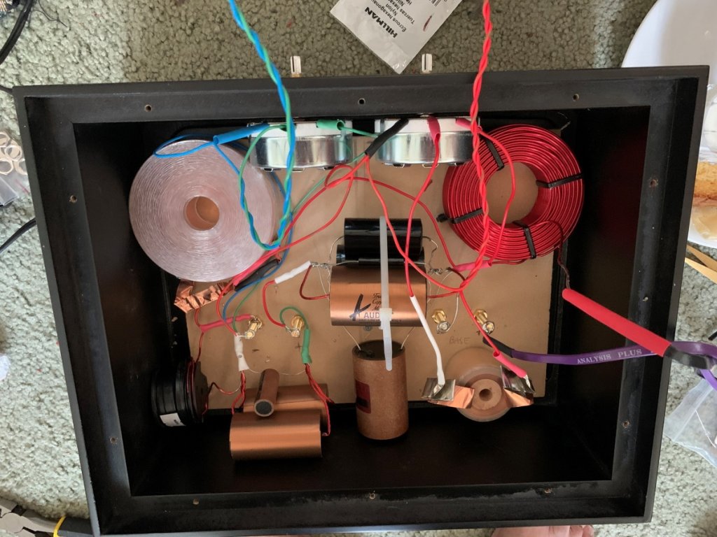

The locations of the inductors and orientation can lead to cross-coupling between stages.
Here is an inductor layout guideline that might help.
shauk786
Posts: 93
Reply #49 on:
31 May 2020, 03:38 am »
Hal,
Thank you for your feedback and diagram on the inductors. I have made some slight changes and hotglued all the components. Fortunately the center of the two top inductors are 20.25 cm apart which seems to be ok based on the diagram. I changed the orientation of the bottom right inductor to be on its side. The bottom left inductor was already on its side. Hopefully that would take care of any potential interference issues on the coils.
Will work on the 2nd crossover tomorrow.

Finally, the passive crossovers are complete.
I am almost done with my rmv60 build. I need to cut some 3 inch dowels for the bases to hold the wings, install the end connectors to the wires, glue the foam on the back of the wings, then test.
Hopefully I will be done in a couple of days.
Cheers.

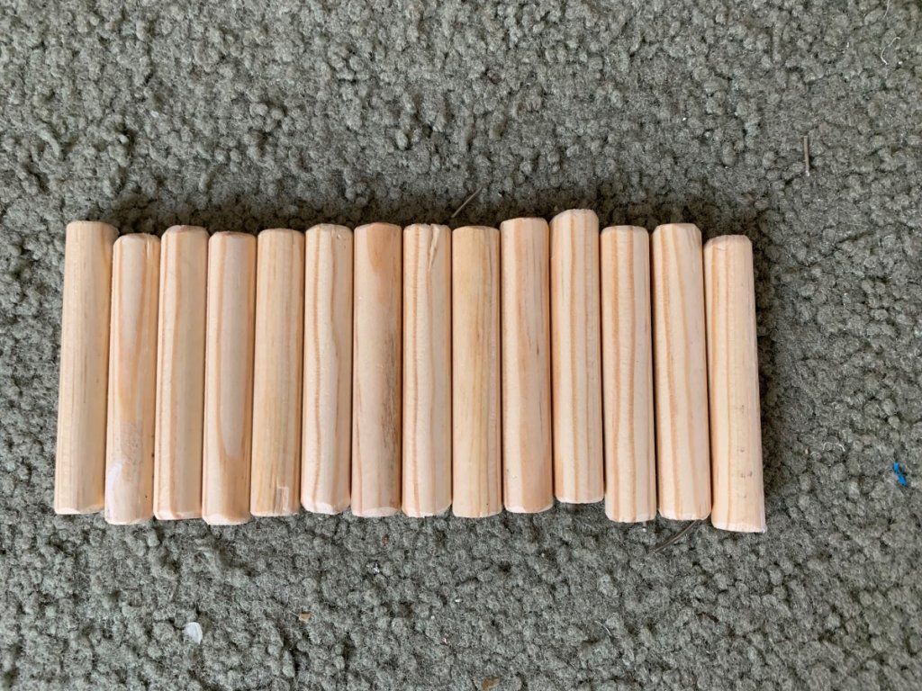

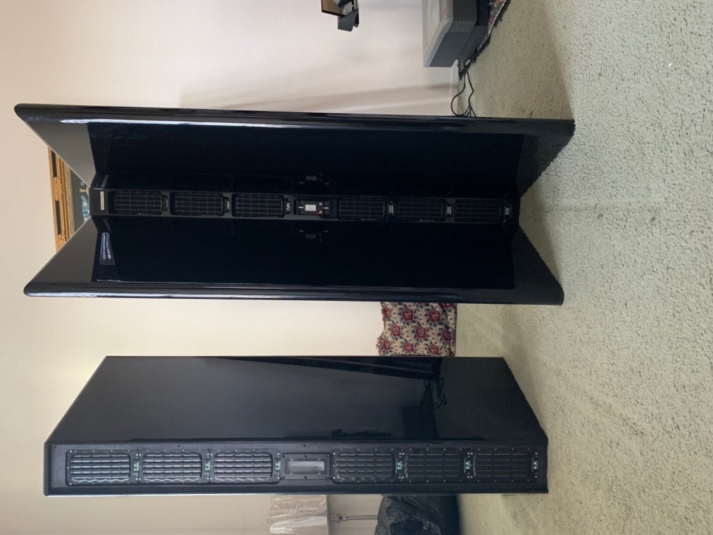

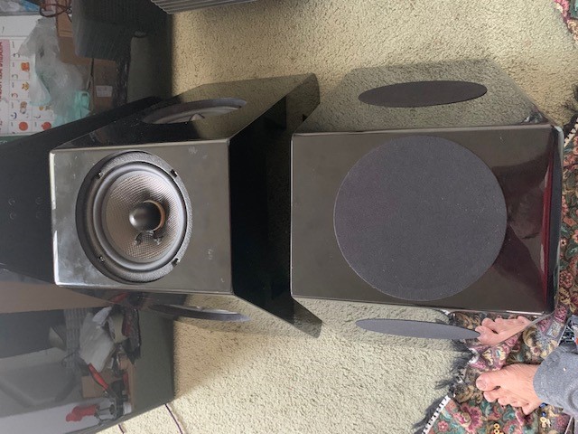

Today I connected BFA banana connectors to all of the wires, six per each crossover box. I also did the dowels.
Question to rmv60 owners: What is the best method to use to connect the wings to the base. I believe it is a challenge to align the dowels to the holes. The dowels could easily be broken if not aligned perfectly. How did you get yours on. Your suggestions will be helpful.
Regards,
Shaukat
Housteau
Posts: 1119
Reply #53 on:
3 Jun 2020, 04:21 am »
I did mine with them laying down. Once connected I carefully raised them up.
At THE Show we did them vertical with two people lifting and a third positioning the base underneath.
shauk786
Posts: 93
Reply #54 on:
4 Jun 2020, 01:06 am »
Thanks Dave,
I did exactly what you did by laying them down. It worked like a charm.
Guys,

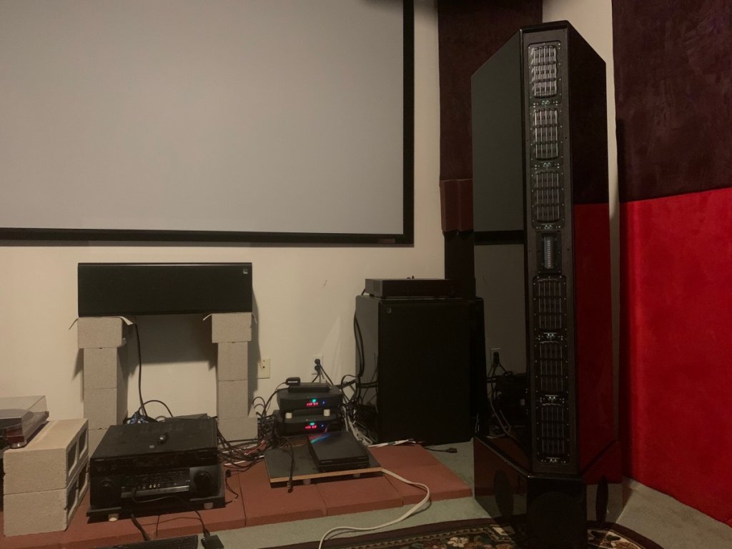

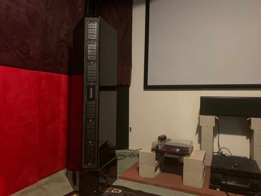

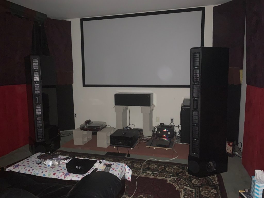

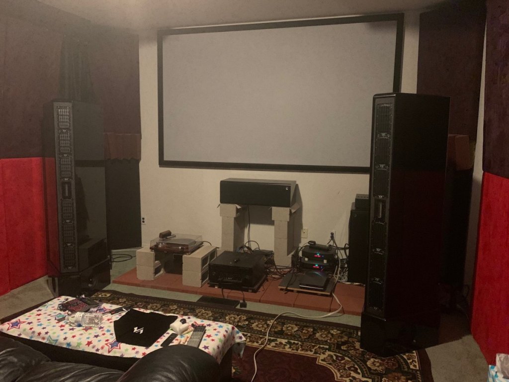

Today, June 3rd. marks the completion of my RM-V60 project. While just looking at the finished speakers, I can only marvel how impressive they look. Like Dave Housteau once said, this is a thing of beauty.
My home theater room is a dark room. So I apologize that the quality of the pictures are not ideal and that they do not represent how nice these speakers actually look.
I thank everyone who has read through all my posts since I started the build. Special thanks to everyone who have given me valuable information and advice here on audiocircle and on the phone. Lastly I want to dedicate this build to the maestro himself, Mr. Brian Cheney, May he continue to rest in peace. VMPS still lives on long after his passing.
Long live VMPS.
After the burning period, I will provide some of my impressions and I hope that John Casler can come by for a listen at some point.
Shaukat
