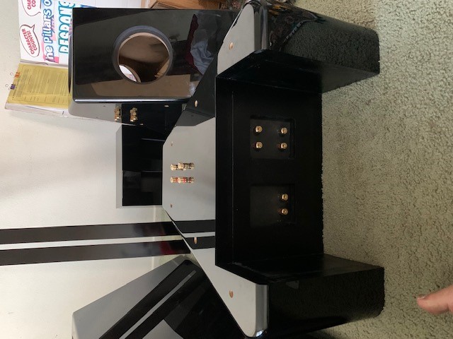

« Reply #23 on: 27 Apr 2020, 12:43 am »
Completed installing midrange and treble binding posts on the top of the bases.
2nd base:
More to come.

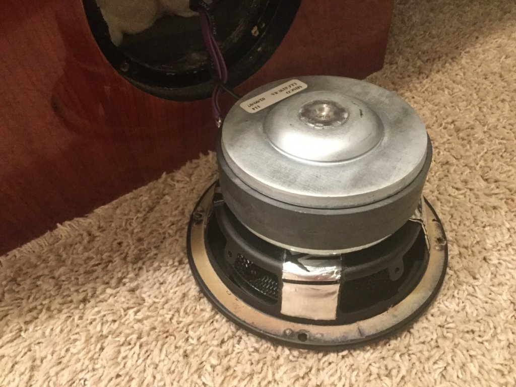

Also how thick is the damping foam glued to the wings?
This is how thick it is on a RM-30. It appears like RM-30 is less recessed than RM-60, but it will give you an idea of material used.

I have now completed the back part of the bases.
Base 1
Base 2
Following some delays, I finally got shipment confirmation from Part Express. I am expecting the foam, woofer gaskets and additional binding posts. According to UPS. should arrive on Monday May 4th. So plan is to complete both bases early next week.

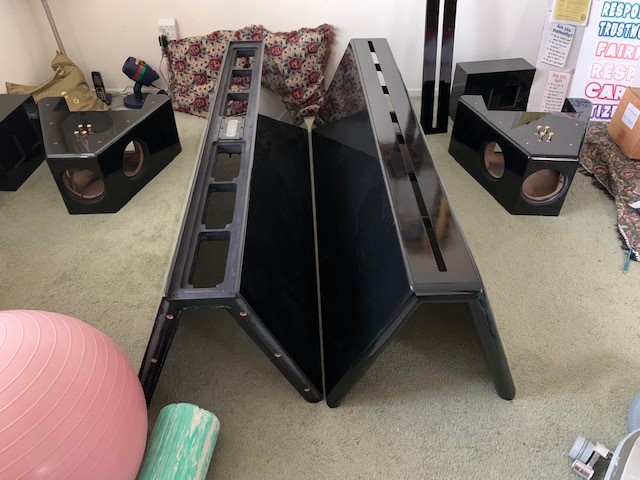

I worked on the OXO boxes this weekend and glad I made some substantial progress. Here are some picts.
I believe most of the hard parts are completed now with no damage to the enclosures. Now I am ready to start assembling and installing the drivers into the wings and bases as my needed parts are being delivered tomorrow.  :D :D :D.

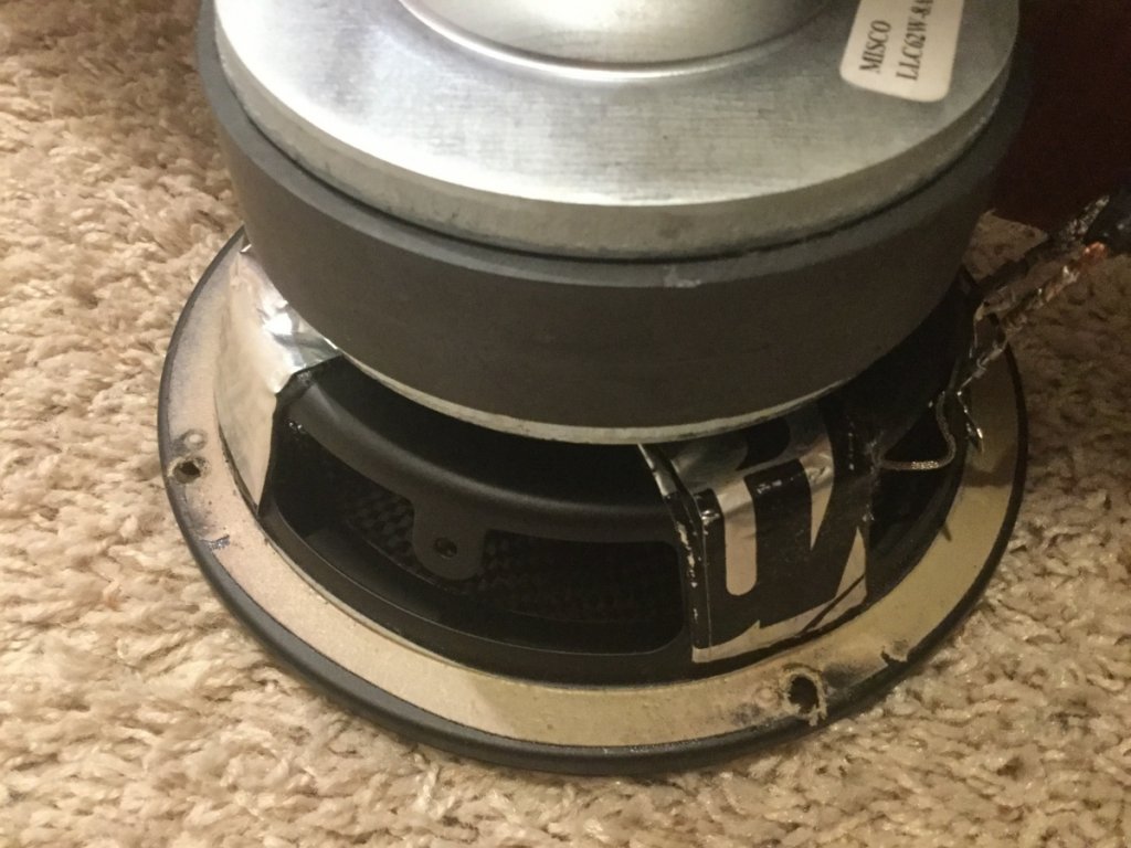

Currently working on assembling the drivers in the bases.
Ken or Dave - Are the round grills completely flushed with the cabinet or does it protrude a bit in the hole once the drivers are installed. I have added a 1/8th inch gasket on each woofer and now the grill stick out by 1/8th inch.  Just wondering if the woofers are installed without any gasket.
Appreciate it for a quick response.
Shaukat
Housteau
Re: VMPS RM V60 question and Build
« Reply #32 on: 7 May 2020, 02:17 am »
My grills are all flush and can even recess in a bit if pushed in.
ZAKski288
« Reply #33 on: 7 May 2020, 02:57 am »
Yes, It might of been 1/16” but now after being screwed down to base cabinet (compressed), it’s real thin now. I just looked at a roll of speaker gasket I have from Part Express, it’s double the thickness. Ken

shauk786
« Reply #34 on: 7 May 2020, 04:53 am »
Thank you both Dave and Ken.
Darn - looks like the 1/8in thickness won't work well. Parts express only had the 1/8in. I just ordered the 1/16 in version from amazon.

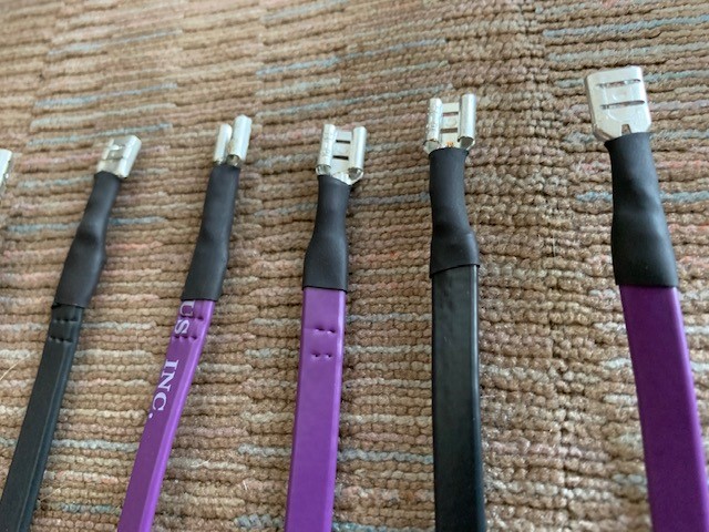

shauk786
« Reply #37 on: 7 May 2020, 11:03 pm »

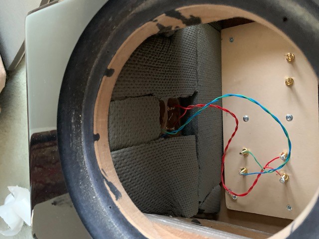

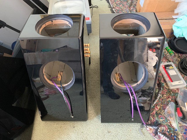

While we are still on the subject of the bases. Here are pictures of the cables I prepared for midrange, treble and base woofers. For the midrange and treble, I am using the same silver plated copper hookup wires used by Brian and they will be soldered directly to the binding posts.
These are:
Hook-Up Wire, UL 1213, 18 AWG, 19 Strands, Silver-Coated Copper, TFE, Red, Red/Green for midrange
Hook-Up Wire, UL 1213, 20 AWG, 19 Strands, Silver-Coated Copper, TFE, Green, Blue for treble.
For the woofers using analysis plus copper, there are 10 strips, 5 for each base, terminated with crimp terminators to each woofer. I crimped each and used silver solder for secure connection then covered with heat shrink tubing. Notice 4 of the wires have connectors on only one side. the bare ends will be soldered directly to the binding posts.
I have seen on some forums that these type of connectors might degrade the signal. However, I am using them only on the woofers. I can always solder the wires directly on the woofer terminals at a later time after listening sessions.
More to come.

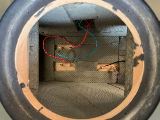

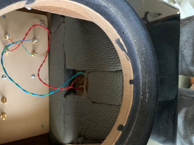

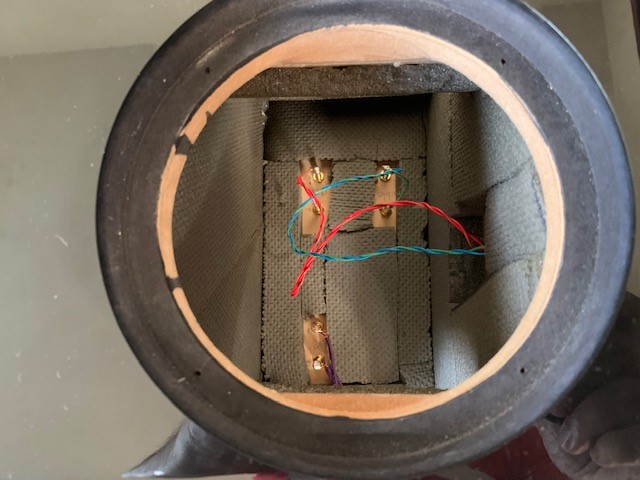

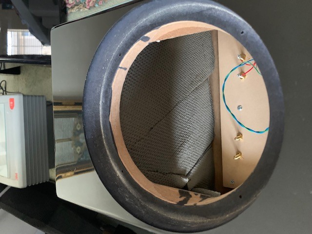

Today's progress on the build.
The Midrange and Treble wires in the bases are now soldered in both bases.
I also started on installing the norez damping material inside one of the base cabinet. I have completed the top and bottom so far.
More to come.
shauk786
« Reply #39 on: 10 May 2020, 12:26 am »

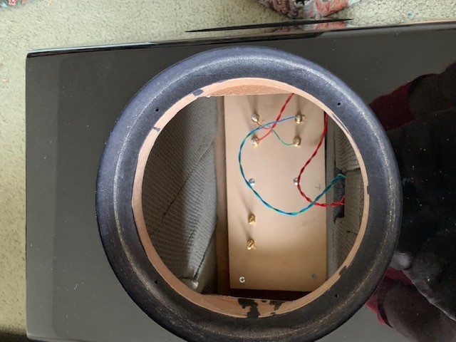

The two bases are almost completed. I am now waiting on Amazon to deliver today the 1/16th thick gasket I had ordered before I can assemble the woofers.  :D :D
All wires inside the cabinet are solded. The damping of the base cabinets is also complete.
Left cabinet
Right cabinet
Waiting for the woofers and the poly fill insulation to be installed:
