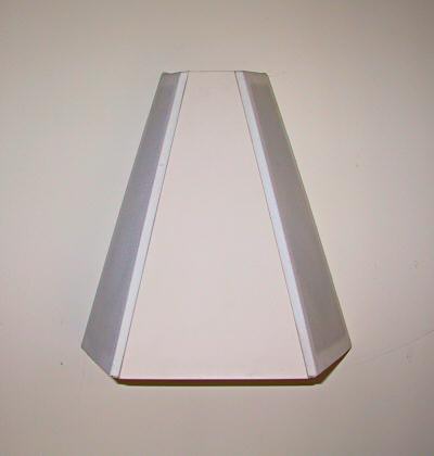

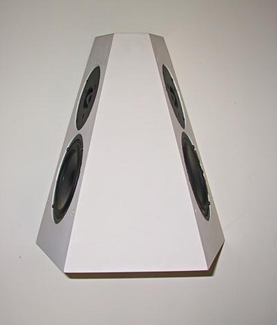

I have an extra Anthem PVA 2 amp so I'm thinking, why not set up an 5.1.2 Atmos system? All I need are a couple of ceiling speakers. Yea, I know: "Not supposed to use bipole speakers for Atmos, blah, blah, blah". It works with big localized sound behind the couch. And I made these speakers so they are staying.
