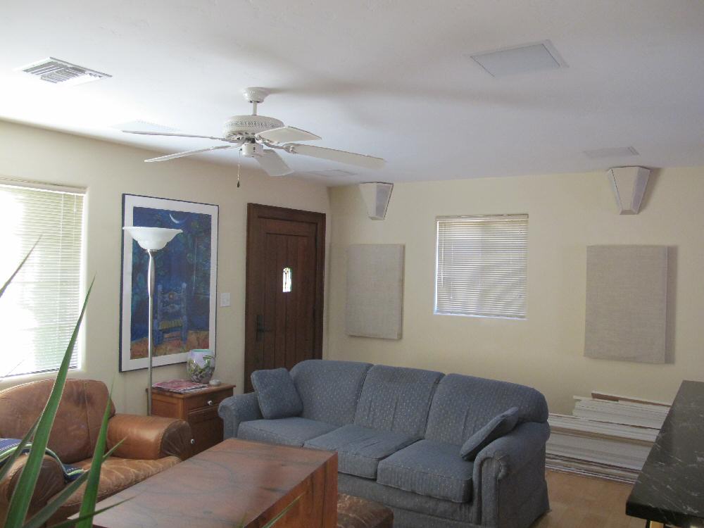

Triad has a user group at AVS Forum and Dawn Gordon suggested using the Inwall Bronze/4 Surround bipole as atmos speakers, which is what I ended up using. The reason for using bipole speakers is that for ceilings 8' and under it is very hard to get the proper dispersion as BRM discovered and my ceiling is less than 8'. I am very happy with the speakers and would use them again. Highly recommended!
I found a pair of Triad Onwall Bronze Surround speakers to use as the surrounds on eBay along with two Inwall Bronze/4 surrounds so fortunately I only had to buy two at retail. Triad only sells through a dealer network, I located a dealer that sells Triad speakers at 10% off, no tax and free shipping:

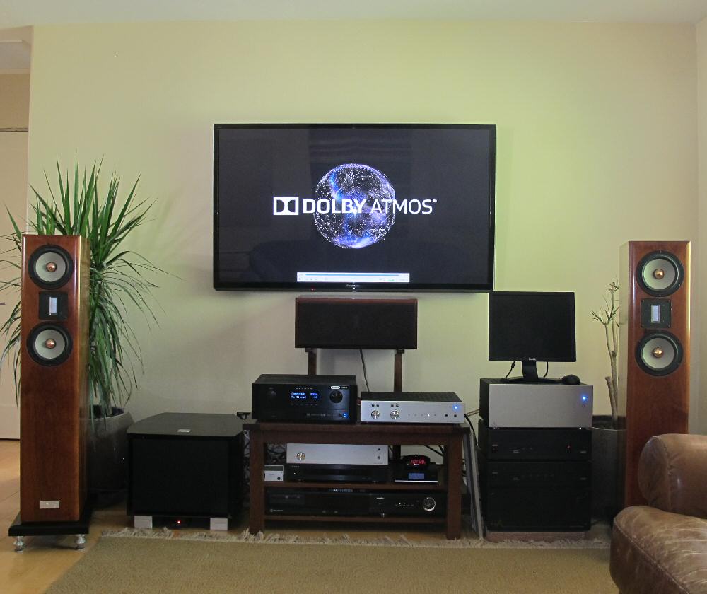

My goal was to incorporate all the changes without drastically changing the uncluttered look of the living room. The front has the REL sub and amp stack, speakers are Salk HT2-TL and Salk HT2C.
There are 8 speakers with a total of 26 drivers in the photo below, the Onwall Bronze surrounds are hidden in the modified ATC sound panels and the upper rear speakers are homemade Vifa bipole surrounds.

Here is a photo of the Triad Inwall Bronze/4 Surrounds mounted in the ceiling along with the Vifa Surrounds I made a long time ago
The Triad Onwall Bronze Surrounds are screwed to a black background, the speakers disappear behind the ATC sound panels grill cloth.
The Vifa surrounds were made from a kit back when Hi-Fi VCR's were popular and part of my original surround sound setup in 1995.
