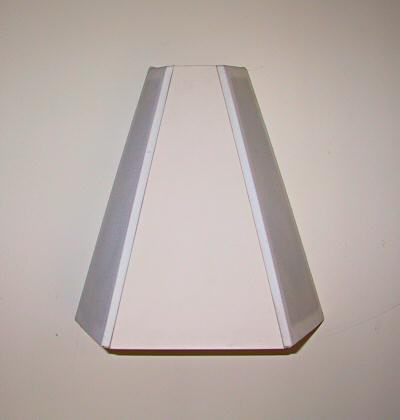

I still use the surrounds I built in 1985, back when Hi-Fi VHS Surround was still alive and the latest thing. The speakers are now paired with Salk HT2-TL fronts and Salk Varacity HTC center speakers and sound great. The dipole design fills the rear of the room with sound, all 4 speakers in each cabinet are now connected in phase so there is some directionality without the pinpoint location that would pull your attention away from the screen. I use an AVA Insight 3 channel amp for the center and surrounds so there is always enough power for clear dialog and death star explosions at the same time.
I don't have any discrete 5 channel music so having matching speakers is not a concern for me.
Each surround has 2 Vifa M13SG09-16 5" woofers and 2 Vifa D27TG05 silk dome tweeters with a 12 dB high pass filter rolled off at 80 Hz. The speakers are painted the same color as the wall and most visitors don't notice them in my living room.
WGH
Re: What are you using for surround sound speakers in your HT?
« Reply #3 on: 22 Nov 2018, 06:52 pm »
The Vifa surround kit I have is at the bottom, I made the cabinet.
