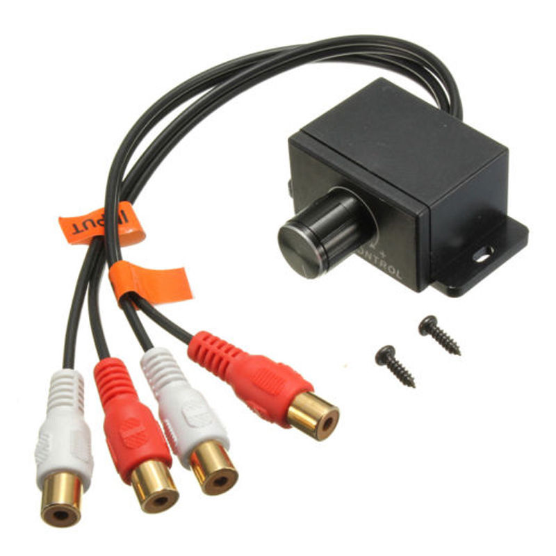

A better bargain?  Who's to say.  But at $3.97, it performs the same function and might be worth a shot.  You could also put a DACT attenuator into it for $20 and still be ahead.
