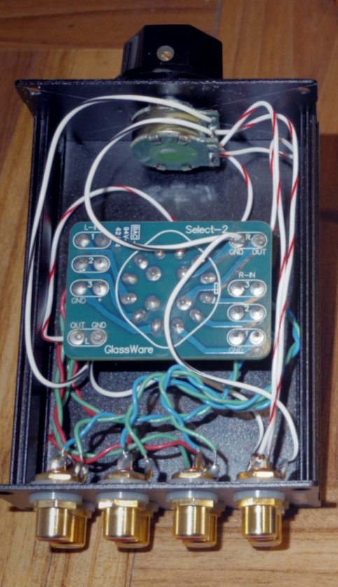

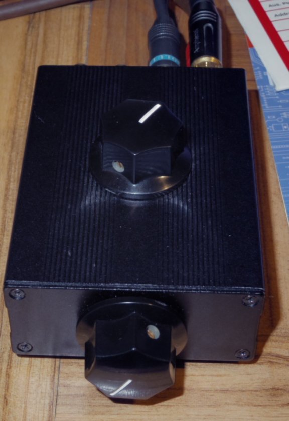

I have always wanted to try the cheap DACT type attenuator that seems to get good reviews, so I added one to an input selector box I built awhile ago. My new cheap and cheerful 3 input passive preamp sounds really good with the DACT type attenuator.

I think that the HKP passive sounds so good because it uses the DACT type attenuator It's the exact same attenuator I used for the one I built which came from the same E-bay seller. It's a pretty easy build for about  $50 to build one with 3 inputs using the Glassware Audio selector switch which has it's own PCB to facilitate wiring.
