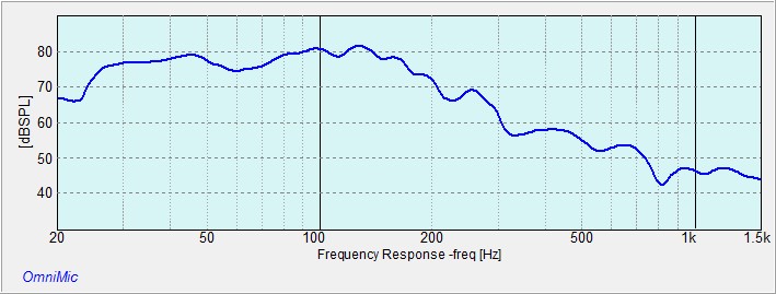

OK so the reason Brian said it will not (or maybe should not is because of the inductance of the voice coil in the woofers. I will try different methods
Note the drop just below 200 hz, Brian says that is room issue. either way you can see it wont make 200 hz
Try the trick of generating a 200Hz tone with your ear right up next to the speaker and see if you can hear it.

Keep in mind that your crossing over point will be where they are -6db down. If you are at an average of 76 then your -6db down point is 65db. You're still hitting 65db all the way up to about 280Hz. So playing up there isn't the problem. You just have a room related dip at around 180 to 190Hz.

I am playing with spk placement.  Still see dip. Grrrr. Time to get agressive. :banghead: :banghead:
You haven't mentioned which side you are having the issue with either. Is it the left side or the right side? Post measurements of each and we can start to narrow it down.

OK so I think I eliminated the 10db narrow dip at 180hz. I pushed the speakers within 2 ft of the front wall, they were pushed about 2 ft closer (didnt measure but probably 8 ft center to center) I had a peak at 45hz which I was able to knock down using the Eq adjustment. The mic is now at the listening position. I moved the bass traps around but seem to have too much affect. see response below.
So would anybody say my work is done with this (left) woofer? Should I do the right now, and then in combo?

That looks pretty good.

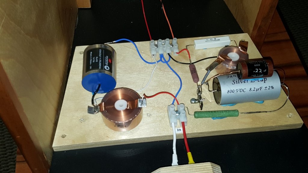

It looked like Jansen (recycled Copper) inductors. Maybe I am mistaken. Looks like Electrolytic caps as a high pass filter. And lots of plastic and possibly steal connectors in the path. I think those typical have hold down screws that are ferromagnetic.
It looks like Cardas Copper binding posts. I like those too. I even stock them, but they are a level down from the tube connectors.
Maybe that is not the final crossover?

Ok yea thats an older pic. I will post newer pics. I understand the terminal strip, that was done to facilitate changes to the XO.

Hopefully this looks better.

Okay, I am still puzzled by that. You have some good parts in there, but the signal is still passing through connectors that are likely held down with steel screws. I see one good quality Mills resistor, one inexpensive but decent Lynk resistor and one really bad sand cast resistor. All of which are in the signal path (including the ones in shunt). Wire looks mixed too and might even be Silver coated Copper. You have nullified some of the good quality parts with some bad, plus connectors.

OK so the green are Mundorf resistors. No good? Also I was told that shunt resistors are not critical. I have them in Mills and can change.  There are some silver coated copper as well as some good copper (I forget if it was OHNO but something reasonably good like that.
I agree with the connectors as I have said it allows me to quickly remove/install to make changes to the XO. I could just eliminate them and solder directly.
