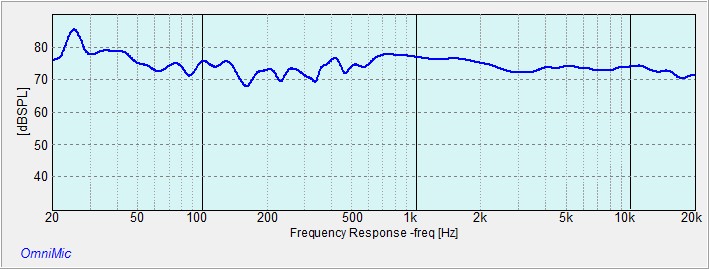

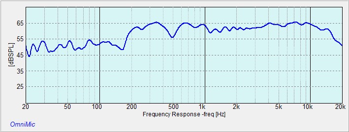

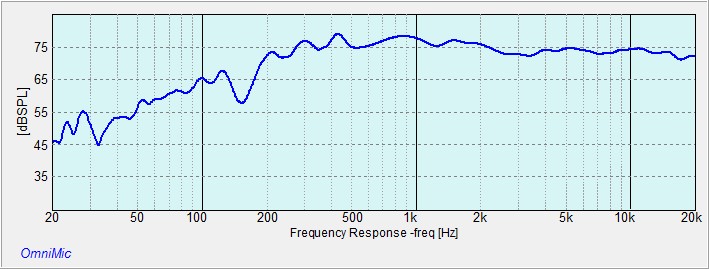

I will try the phase control again, but I believe I tried that and it didnt help much. I omly have one speaker on at a time. Confirmed I am in the AVR position. As far as the gain, if I bring it up then it will be too loud compared to the toppers. But I will give it a go. I was measuring at about 1 meter from the baffle. I'll measure from the listening position. But I did want to confirm that the amp does not go much higher than 150 hz, correct?
mid only
woofer only
I'll try to get the sum of the two so you can see.

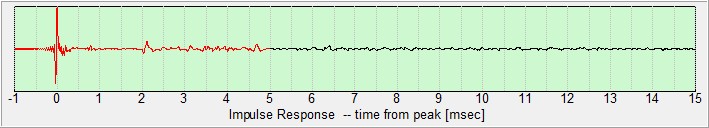

OK so I am working on the XO and very interesting, I am using a 2 way 12db/oct and the system measures better with both drivers in phase! OK so what could I be doing wrong.
The other issue is a crappy looking impulse (tweeter only)

I take it that is your upper section?
First of all I can tell by the impulse response that you are way too close. Back off to 39". Then set the start time on the impulse response to about 2.75ms and stop it at 6.75ms. That will give you a good clean time window of 4ms without room related reflections. And be sure that the speaker is not sitting close to a side wall for the measurement. And start off with the response on the tweeter axis.
When looking at a 1 meter gated time window you can crop everything below 200Hz because you really won't be measuring or catching anything below that.
And with that type of crossover they may very well measure better with both drivers in phase.

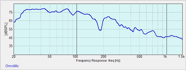

OK so rather than mess with my current physical build and XO i decided to insert my minidsp into the line and play with that. Settings are as follows:150hz +2db Q=1.6 (This improves integration with the H Frame)
450hz -3db Q=2.8 (removes peakiness in the Mid) Sounds better.

Ok so after some investigation and analysis Brian Ding acknowledges that the the amp limit on the top end is about 150 hz. My toppers go down to 200 hz. But he thinks that the major culprit is a cancellation in the room. He does believe that I may be able to "smooth" it out somewhat by experimenting with room placement. Currently I am 3 1/2 ft from the front wall and 6 ft from the side wall. I remember reading where it said to start close to the front wall and move forward in 2 inch increments until I get the best spot. Any thoughts on this?
mlundy57
  • Posts: 3643
Re: Open Aire Aktiv build thread
« Reply #77 on: 24 Sep 2017, 07:39 pm »
In the open baffle configuration these are supposed to play up to 300Hz.  I just checked out my H-Frames. I didn't turn on the power amp to the top sections so only the H-Frames were playing. I used discrete sine wave tones from 20Hz to 400Hz. The tone files I have include 100Hz, 250Hz and 400Hz (nothing in between). With the crossover turned all the way up (pointing at 150Hz), output was solid at the listening position to and including 250Hz. While audible, 400Hz was significantly diminished.
As long as your amps have the servo control board with the OB circuit for the SW-12-16FR drivers and everything is wired correctly I'm not sure why you are not getting this type of output.
Unless you are using a version of the A370 amp that has both "Line In" and "LFE In" RCA jacks (A370-PEQ3, -XLR 2 or -XLR 3) and you have the RCA interconnects plugged into the "LFE In" jacks. When this happens the crossover control knob is by-passed. The "LFE In" jacks assume you are setting the crossover points in a home theater receiver.
If you are using the A370PEQ version of the amp this is not an issue because it does not have any "LFE In" inputs.
One way I was told to troubleshoot if it is a speaker issue or a room interaction issue is to stick your ear right up to the opening (or even a little inside the opening) of one of the drivers and play the tone. If you can hear the tone with your ear right at the opening, so there is no chance for any room interference, but cannot hear it (or it is significantly diminished) at the listening position there is a room issue. If you can't hear it right at the speaker opening it is a speaker issue.

« Reply #79 on: 24 Sep 2017, 08:47 pm »
See response embedded
In the open baffle configuration these are supposed to play up to 300Hz.  I just checked out my H-Frames. I didn't turn on the power amp to the top sections so only the H-Frames were playing. I used discrete sine wave tones from 20Hz to 400Hz. The tone files I have include 100Hz, 250Hz and 400Hz (nothing in between). With the crossover turned all the way up (pointing at 150Hz), output was solid at the listening position to and including 250Hz. While audible, 400Hz was significantly diminished. <<I will try this method>>
Unless you are using a version of the A370 amp that has both "Line In" and "LFE In" RCA jacks <<No>> (A370-PEQ3, -XLR 2 or -XLR 3) and you have the RCA interconnects plugged into the "LFE In" jacks. When this happens the crossover control knob is by-passed. The "LFE In" jacks assume you are setting the crossover points in a home theater receiver.
If you are using the A370PEQ version of the amp <<Yes>>this is not an issue because it does not have any "LFE In" inputs.

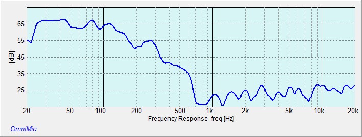

OK so the reason Brian said it will not (or maybe should not is because of the inductance of the voice coil in the woofers. I will try different methods
Note the drop just below 200 hz, Brian says that is room issue. either way you can see it wont make 200 hz
