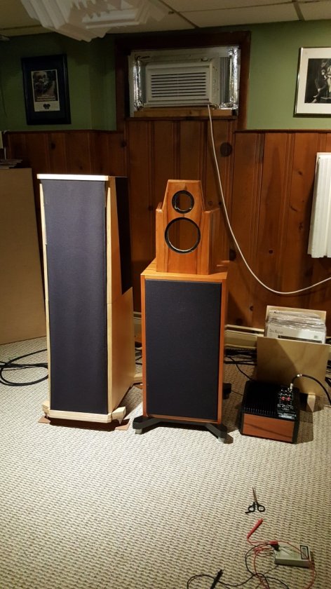

more progress this weekend. Grills are done, the wiring done bu getting a loud buzz from the speakers. very confusing because I checked the wiring and it seems right.
Grill complete, top ready to accept drivers
Base and XO board completed. Ready to start populating

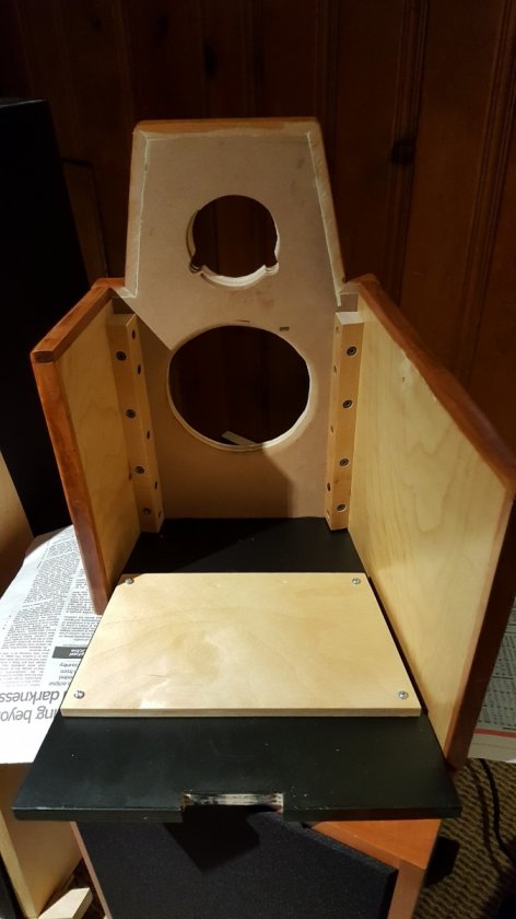

Updates this Labor Day Weekend!!

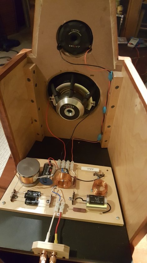

This is Rev 0 XO installed. I generally dont install the good stuff until values are finalized

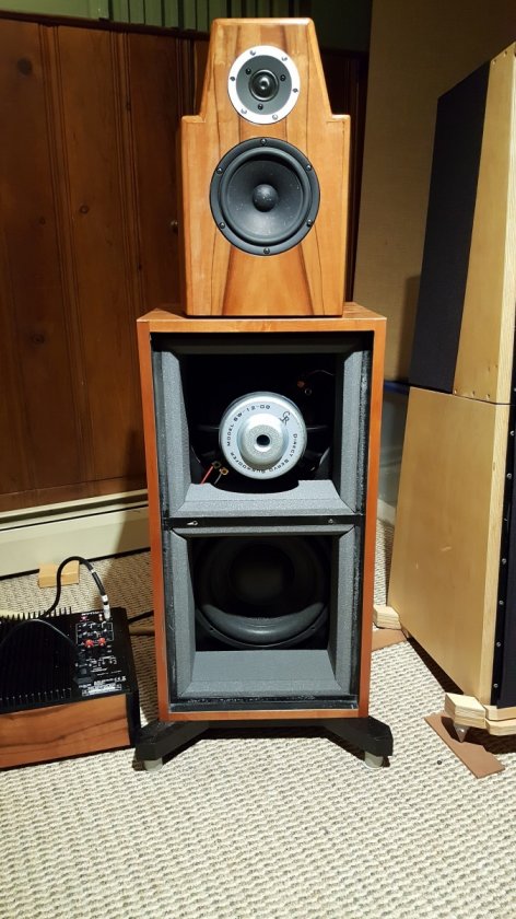

I was inspired by MLundy and the way he beveled the NoRez so I did it as well. I believe it adds a nice touch.

Ok so I fired the babies up and did a bit of listening and measuring. Tweeter is padded a bit too much, easy fix but the harder issue is I have a dip in the Fr at about 170 hz. So here is my set up
ModWright LS100 preamp main outputs have a cap installed to limit bass (approx 80 hz). This goes to my KWA 100SE No active crossover for the top.
Second pair of output (full output) from the preamp goes to the Rythmik A370 bass amp.
I measured the midrange only w/o xo and it goes nicely down to its designed cutoff at 200hz.
I measured the H Frame woofers and I cant get them to go any higher than 150. Hence the gap.
Danny previously mentioned that the woofers-amp combo go up to about 300 hz so I figured I was good. What am I doing wrong?
