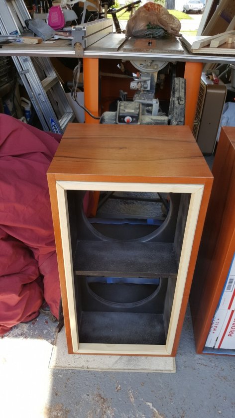

« Reply #26 on: 8 Jul 2017, 10:04 pm »

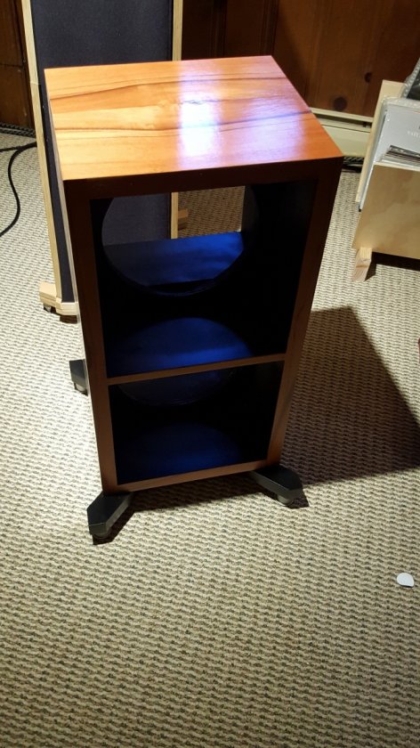

Cabinets coming along too. Next I have to add fabric to grill and install NoRez.

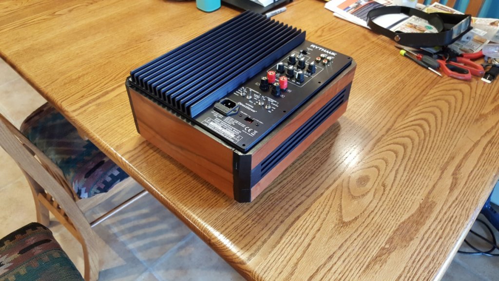

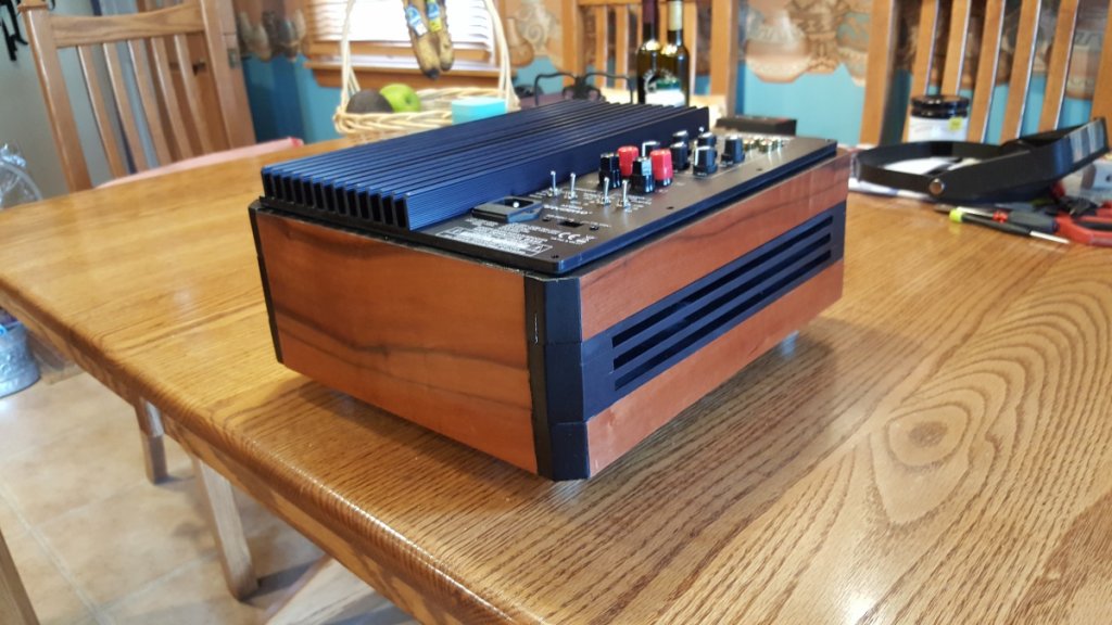

« Reply #28 on: 9 Jul 2017, 12:37 am »

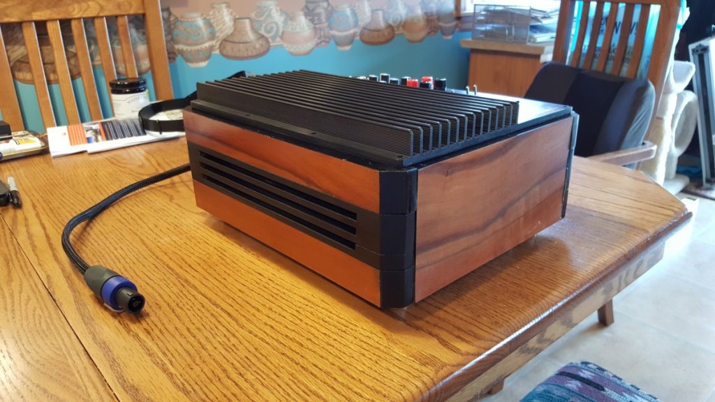

Thanks, the detail is functional as well. provides venting for cooling. Not sure it needs it but figured it was unique.

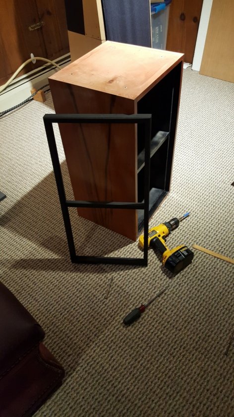

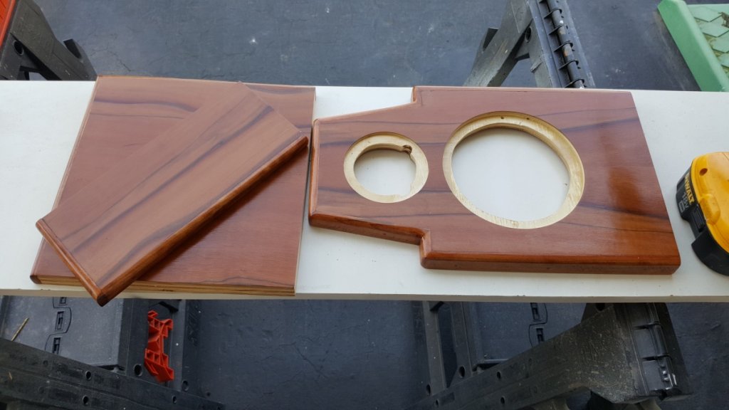

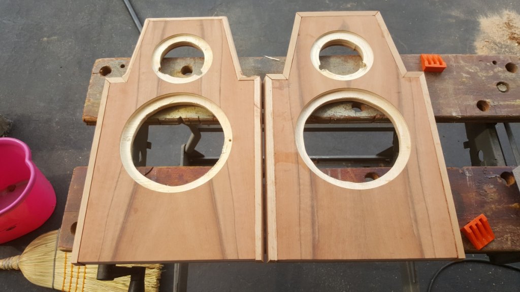

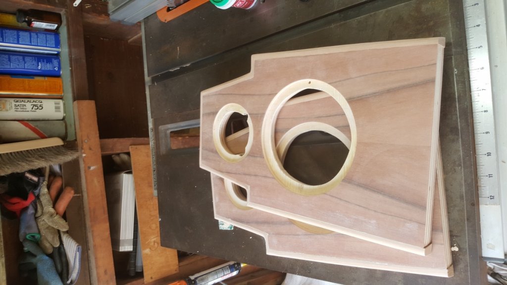

So these are the fronts. Banded in solid cherry. Sides are also cut I just have to band them as well.

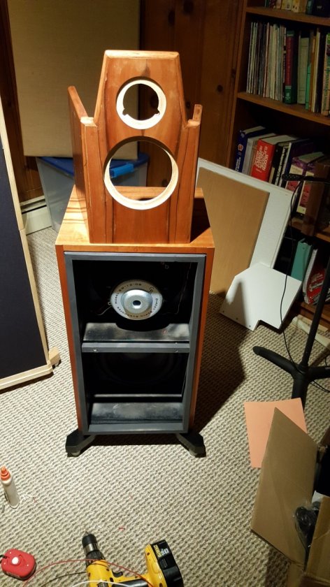

It's has been a while since I last posted. I did a 8 day vacation which knocked out 2 weekends of progress but I am back at it.

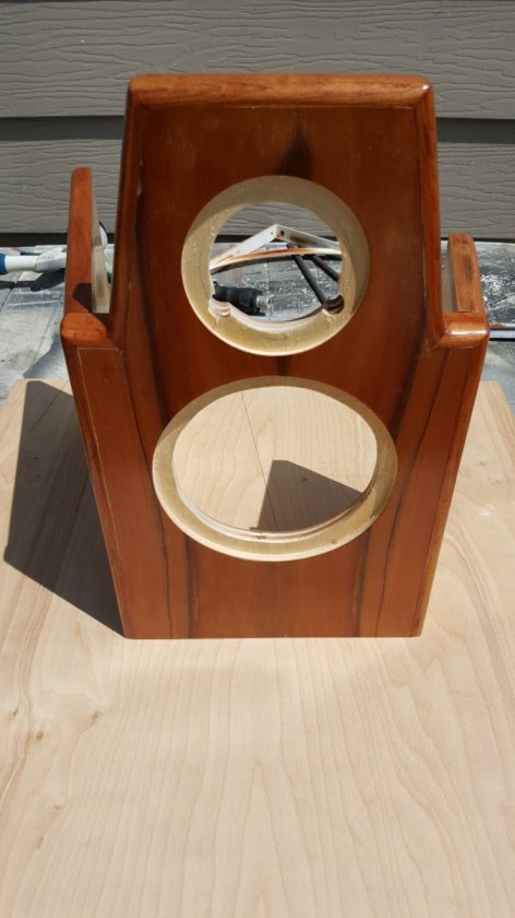

Uppers after applying finish
An assembled upper w/o drivers
Time to bring in and start working on a finished assembly

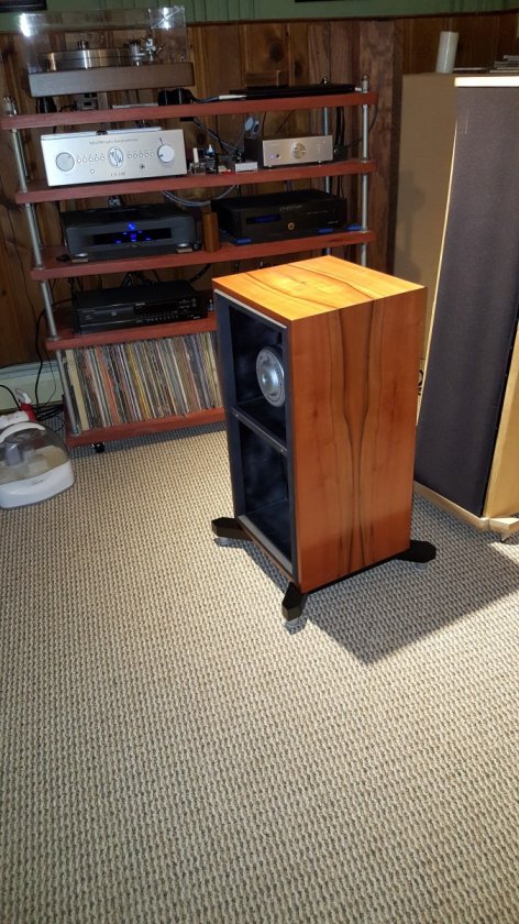

« Reply #33 on: 16 Aug 2017, 10:29 pm »

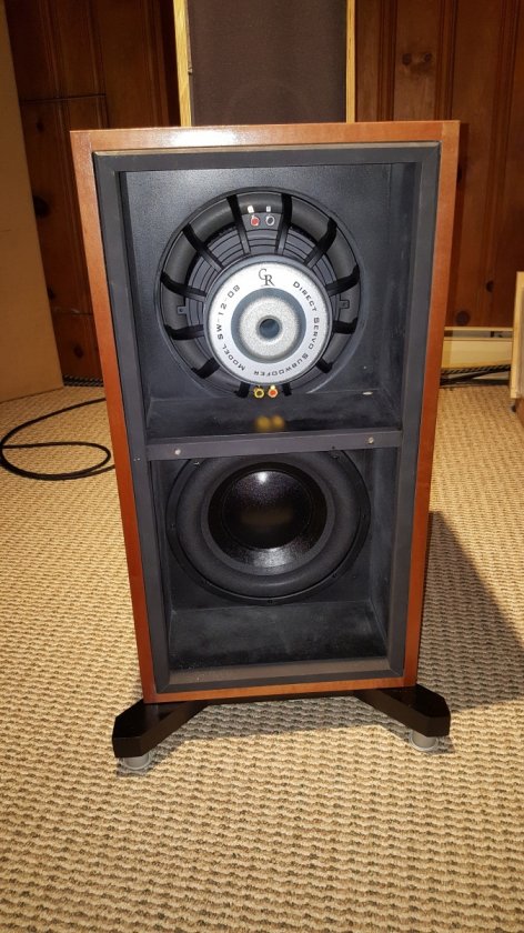

Hmmm, I just noticed that my lower woofer faces me and the upper is facing away from me. That is the opposite of the standard configuration. My XO is about 225hz. will this be an issue?
mlundy57
  • Posts: 3643
Re: Open Aire Aktiv build thread
« Reply #34 on: 17 Aug 2017, 12:36 am »
As long as you have them wired out of phase you will be fine.
Here's a thread Jay posted about this with wiring diagrams
http://www.audiocircle.com/index.php?topic=149708.msg1618744#msg1618744
Mike
jimbones
  • Posts: 362
« Reply #35 on: 17 Aug 2017, 01:14 am »
wired correctly yes (opposite phase). and the servos are connected in series. Thanks.

« Reply #36 on: 17 Aug 2017, 01:46 am »
The servos are wired in series but they have to be wired out of phase also.
jimbones
  • Posts: 362
« Reply #37 on: 17 Aug 2017, 01:53 am »
OK I'll pay special attention to that. Thank you for pointing that out Mike. Theres a good possibility the SC is not wired correctly. I haven't connected them to amps or used them yet.
