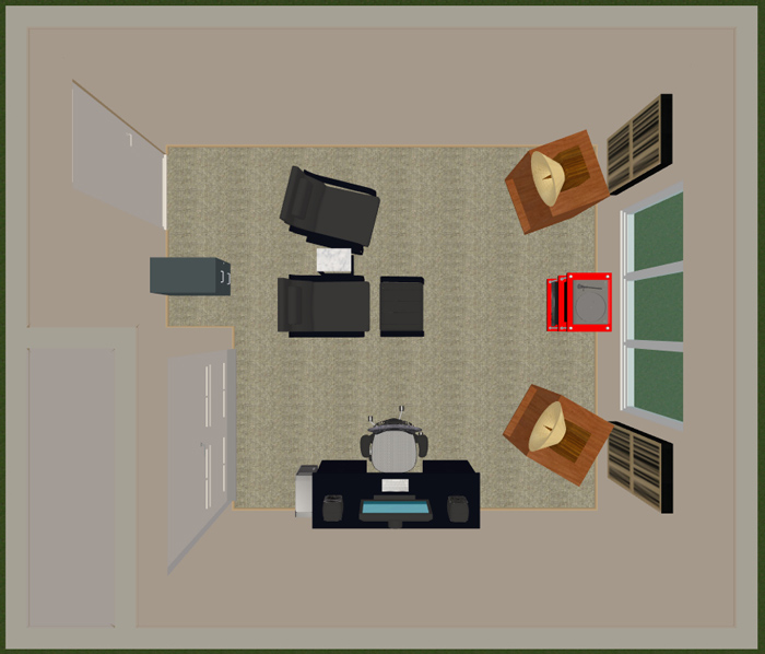

This is sort of a good representation of my room. It's pretty small and with the Super Vs, I'd have them out of the wall a bit more than is pictured here. So I'd be listening pretty close, where the co-ax would seem to have an advantage.
I go back and forth between the speakers in this arrangement vs. on the long wall with my desk against the windows. I do need to think about treatment, too, but that is a whole other discussion.
