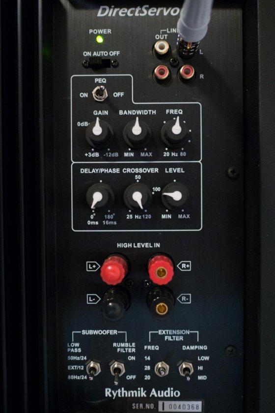

[7] Decware MiniTorii amp with line level outs to power the sub amps
[8] Sub amp settings -- still tweaking bass level, but had to turn down quite a bit to match output from my 4 watt amp.
Shakeydeal
Looks good. Just a suggestion though. I was using line level inputs to the sub, but I switched to the high level inputs and the sound is MUCH improved. You should try it and see what you think.

danvprod
Interesting @shakey. I wonder why that is? I will try that as well.

Shakeydeal
Amazing how much bass these H-frames put out. Just in awe. First track from Neil Young's Le Noise has some serious power. They are speakers made for rock for sure. Need bass traps though, definitely need some bass absorption bad.
Well part of the reason for me is that my preamp at the time didn't have an extra output, so I had to use a splitter. Then the impedence of the sub amp is added to the main amp. I think my preamp didn't like that. It's much, much better using speaker level. And it's easier to get the sub blended with the main driver this way.

danvprod
Ah that makes sense. I fortunately do not need to use a split on my main amp as it has a separate line level out that is tied to the volume control. And is passes through the same tube preamp stage of the amp, which is giving the plate amps the same sonic signature as the mains (also a good thing). I haven't done any measurements yet, but they seem pretty to integrate.
I did get a pair of the fMod line level passive HP filters, but I don't see any way to make those work with my amp without a splitter. It would be nice to free the amp from having to reproduce those low frequencies, but I don't know what trade off is better (run the tube amp full range and use the line outs to the plate amps, giving the plate amps the same tube sig. as the mains) vs. getting the extra power out of the tube amp. I'll play around with it.
