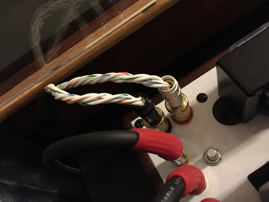

Worked on building my new speaker cables last night. Some Teflon Mil-Spec Wire, Silver Plated PTFE 5 conductor 16 AWG per conductor. Twisted together they should be able 9 AWG. Everything is wrapped in tech flex and terminated with BFA connectors.

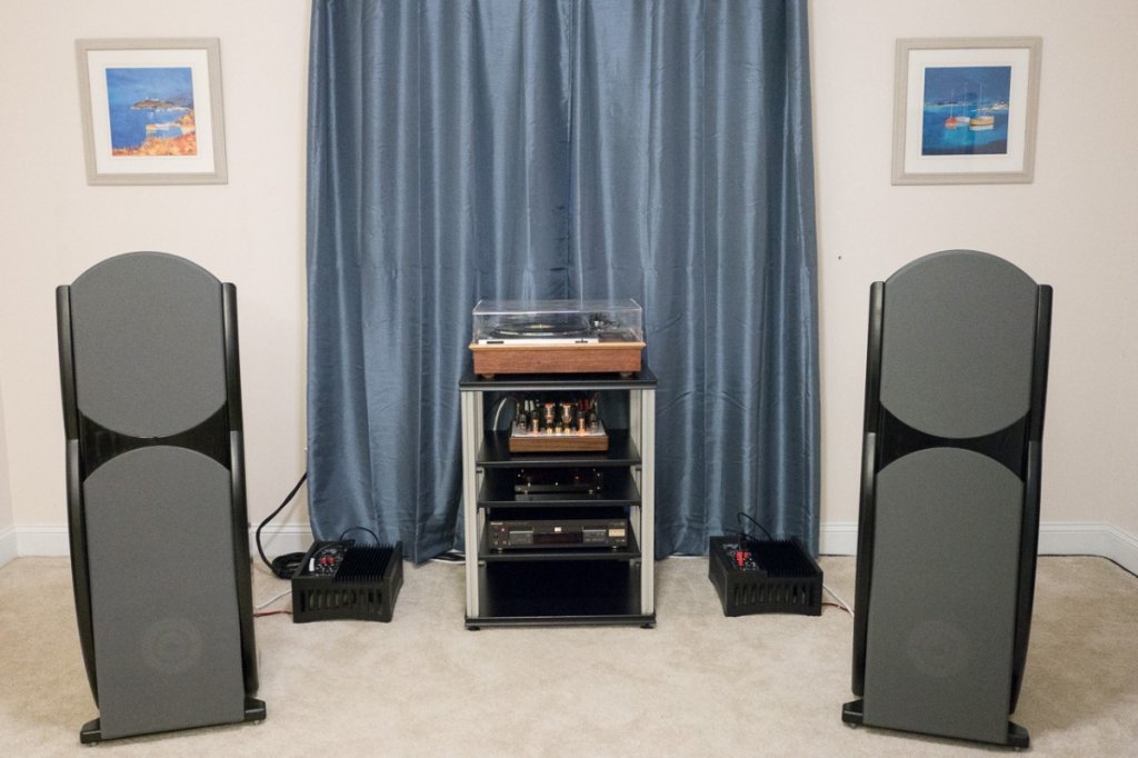

Shakeydeal
Looks good Dan. Here are some recent pics of my system with the new amp.

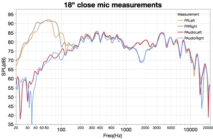

Finally making some measurements of these:
Subs are set at 180 degrees phase, 80 Hz XO frequency (might be too low). High damping, 14 Hz cutoff, no EQ. Subs might be set too low in cutoff frequency.
This is with the four GIK bass traps in place.
Danny Richie
That's a pretty typical in room response measurement. Not too bad.
If you are going to use the 14Hz extension filter then also try the low damping setting with it.
danvprod
These are measurements about 18" from the bow tie, between the P-Audio driver and the sub array. Mainly for doing level matching between channels, since I seem to notice on some tracks the center image being pulled towards the right speaker (could be my room). They match well. A couple of learnings.
1) I must really like bass. I love that the Super Vs accommodate what sounds good to me. I don't think I could ever go back to a speaker that doesn't let me adjust the level of frequencies < 100 Hz independently again.
2) I have no idea what the 10 dB dip at 1.8 kHz is. Could it be a reflection from my desk on the right, or some sort of cancellation from the front wall?
3) These are really the first speakers that have sounded excellent in my room -- I know that I have added the bass traps, which also help, but I think something has to do with the extra LF energy, the slight depression between 1-3 kHz and the extension down into the 20s.
4) Maybe my subs a bit too loud right now ;)
Danny Richie
You're going to have to back off to the listening position to really know what's going on with your room response.
Keep doing one speaker at a time and try the subs individually too.
Then a clear picture of what's going on in your room will develop.

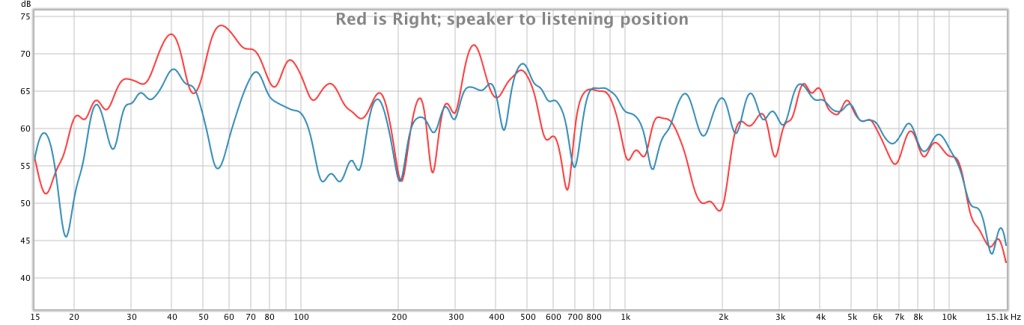

Added some QRDs on the front wall.
danvprod
This is really cool. The imaging issues I had are completely resolved by adding these diffusors. Many tracks, I didn't have a stable, center image, it would be pulled to the right. Vocals would be just enough off to the right to bother me. Now I'm getting a solid center image. It's a subtle, but definitely perceptible improvement to the soundstage.
danvprod
 I put a spatial audio black hole on my back wall to deal with my axial mode at ~ 41 Hz. It works quite well and complements the GIK soffit bass traps well. It's good for about 3 dB. It also helps with the modal ringing, too, as can be seen by the EDT plot.
I may add another one! And I also plan on still adding the 2 soffit bass traps, and some first-reflection absorbers in a minute...
