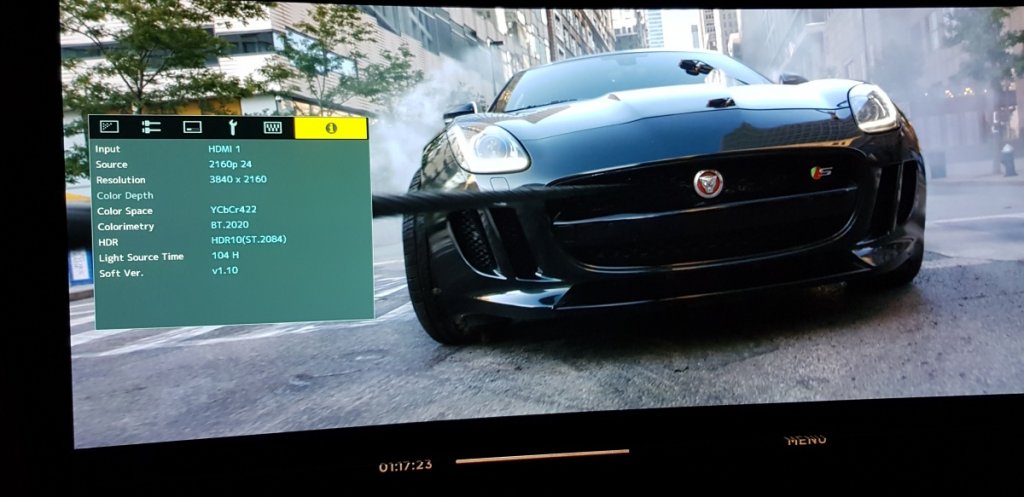

Just want to let you guys know the SP3 hdmi 2.2 upgrade was a complete success.
Manage to connect the modified SP3 to our JVC Z-1 (RS-4500 over your place) and it pass through 4K HDR with no issues using our Oppo 203 and Panasonic UB-400 UHD disc players.
Switching between normal Bluray and 4K Bluray HDR content were hassle free, switching between the hdmi inputs of the SP3 were again problem free, maybe just a tad slow for 4K HDR picture to lock but nothing to complain.
Picture performance was brilliant through the SP3 and of course you have the usual brilliant SP3 sound for blurays and 4K blurays all through just a single hdmi cable to the SP3.
Again a fantastic job done for which we will whole heartily recommend this upgrade to our existing SP3 customers.
