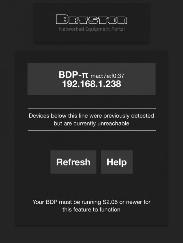

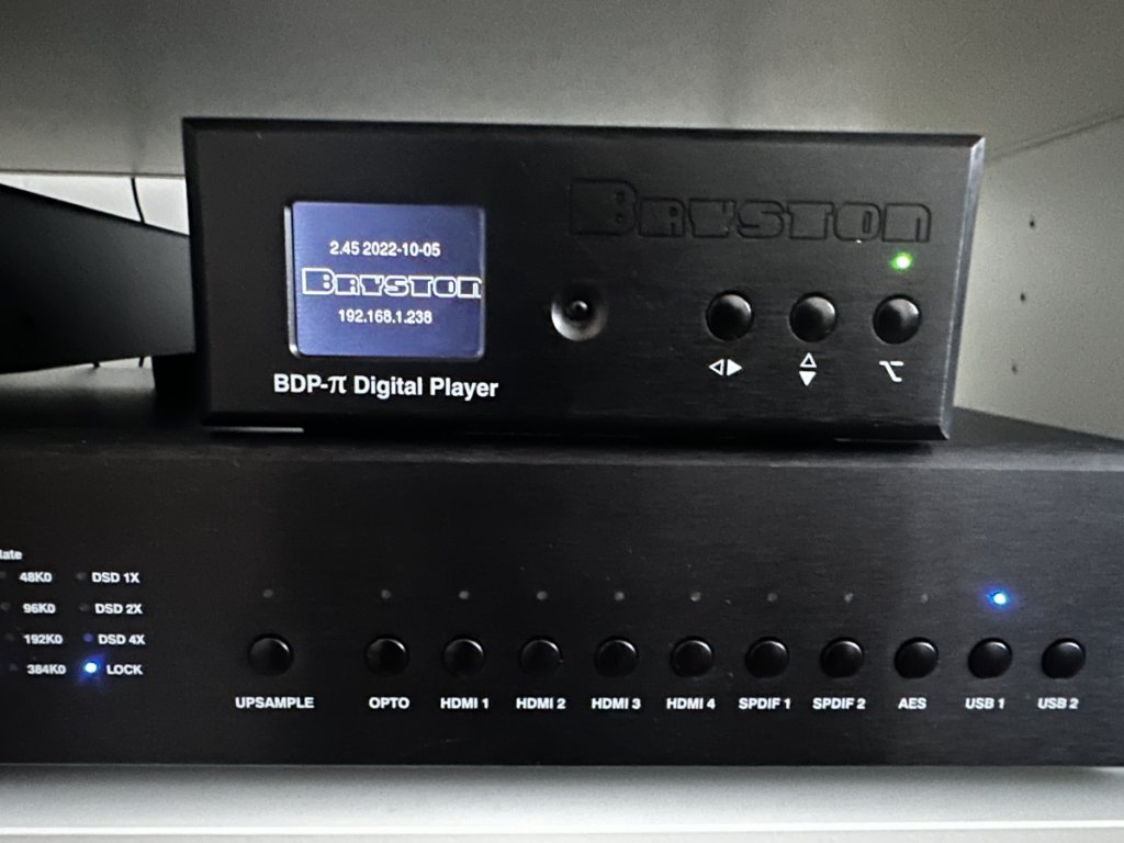

I recently picked up a used BDP-Pi to replace my home-brew RaspberryPi streamer. When I connected it updated the firmware and after it rebooted it now stays stuck at this screen for a some time before going to a full black screen:
The buttons are not responsive. Typing the IP address in a browser returns a not found error, so does http://bryston-bdp-pi.local; mybryston.com however does!
Selecting the device from that screen just returns a not found error just like when typing the IP address out.
The funny thing is that Roon does "see" the BDP-Pi and can play to it!
I should not have allowed the firmware update! I'm guessing I need to get an image to write to the card inside...
