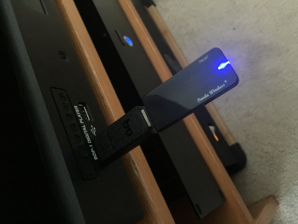

Apologies if this has been addressed already; recommendations for wifi dongle for the BDP-Pi so I don't have to punch a ton of holes in the walls of my house?  Right now running Netgear powerline which is spotty, and my dogs keep chewing through the ethernet cables.  TIA.
You can use Bryston's own dongle wireless adapter of course. I bought a Panda Wireless Pau07 for around $20 for use with my BDP-1. It works flawlessly. It has both 2.4 and 5 Ghz support. Very responsive, stable, and hasn't overheated in my setup. I've used it for weeks at a time without turning the unit off. You can even use it with things like Audioquest Jitterbug and it will work fine.
