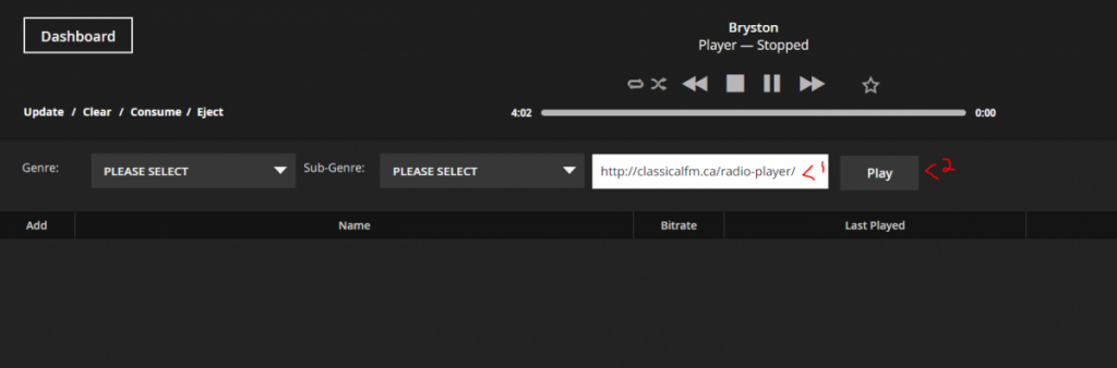

Our firmware supports playing icecast and icecast compatible streams like this one
http://classicalfm.ca/radio-player/
You can copy URLs into the search field of bRadio and the BDP will attempt to find any usable streams/playlists linked in the given web site.
YouTube uses a rather proprietary system and as far as I am aware playback isn't supported outside of an official app or web browser.
