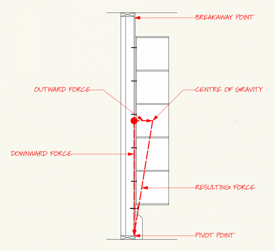

I'm not an engineer (though I work with hundreds of them), but it seems to me that you diagrams are correct so long as your top priority is keeping the back of the shelves on the wall.  I just think the LPs will want to another direction.  Down and to the right, because THEIR pivot point is at the wall in each tier.
SteveRB
Re: Record Shelf and vinyl weight
« Reply #22 on: 20 Mar 2016, 08:42 pm »
Yeah. And each tier will weigh a fraction of the whole. The shelf itself will be glued and screwed 3/4" birch ply. It will take that weight easy. I mean if we can load up ikea boxes...
Ahhh, I didn't catch that part!  Crap, that's gonna be heavy on its own.    :D
SteveRB
« Reply #25 on: 20 Mar 2016, 10:01 pm »
yup. but even if the entire structure weighs 2,000 lbs. thats still only 285 lbs per stud -- 13% of it's loading capacity.
Placing legs on it only distributes very little. The joists carry the load to the far side of the room to the next bearing wall 14' away -- so less than 5% of the LPs weigh is actually distributed downward.

But you're right, it would be fine all in 1/2" ply. Glued and screwed.
