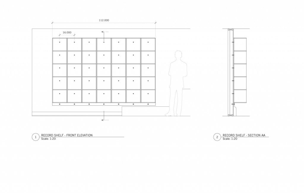

Ok, here is a basic draft. Lets assume the shelf components are all glued and screwed. Each vertical section is it's own unit (so it can be moved easily and re-installed as a system).
There is a horizontal stringer, 1" thick picking up the weight at the bottom. All screws are installed with at least half their shaft in the stud. Washers are used. All screws in shelf are #8; all screws in the stringer are #12.

My only real concern is will the weight ON the wall cause the studs to pull out at the top. I think my calculation above of 15% of the toal load, may be closer to 2%... which means i'm fine.
I actually just spoke to a contractor who used to build apartments like this for this developer. He said as long as the screws are sized to hold the shelf to the studs, the studs aren't going anywhere.
