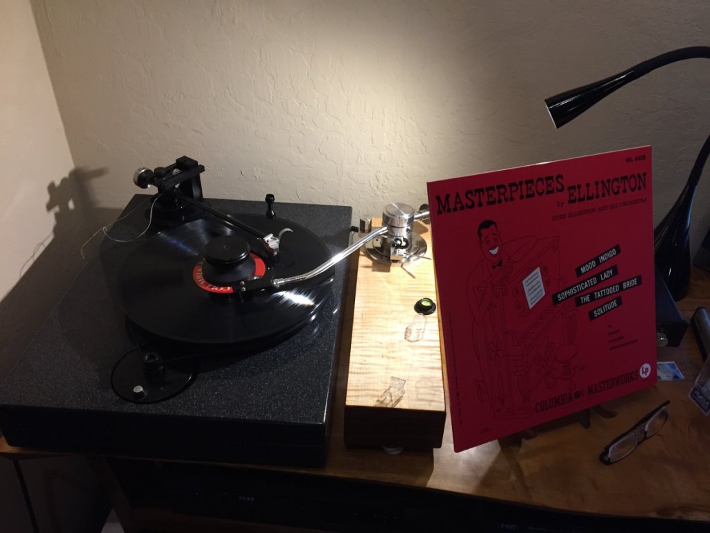

Update:  Both arms/cartridges are dialed in and playing music!
In taking this picture I realized that the Zero is a pretty good high-frequency receiver, as I could hear my iPhone when in a certain position (the Lyra doesn't do this).  I did an A/B on "Masterpieces by Ellington" and both cartridges sound really good.  The Zero is more romantic, with mid-bass bloom, but at the same time extremely detailed.
Will let things settle in before making any other changes.  The outrigger seems stable enough for the time being, but I am getting more sound than I'd like when I tap the shelf. Also, when the WTT/Lyra is playing and I tap the outrigger it's louder than when I tap the shelf.  Not sure what to make of that, but will need to address it at some point.

"when the WTT/Lyra is playing and I tap the outrigger it's louder than when I tap the shelf.  Not sure what to make of that, but will need to address it at some point."
The pod is amplifying your tap - like the crack of baseball bat when it hits the ball.    It would help to reduce the size of the pod, but you need to increase the weight.  Adding other types of material (massive) would help.  You could hollow out a section and fill it with sand and/or lead.  Lead works like magic killing vibrations.
neo
Neo,
I figured as much.  I'll add some lead and see what happens.
