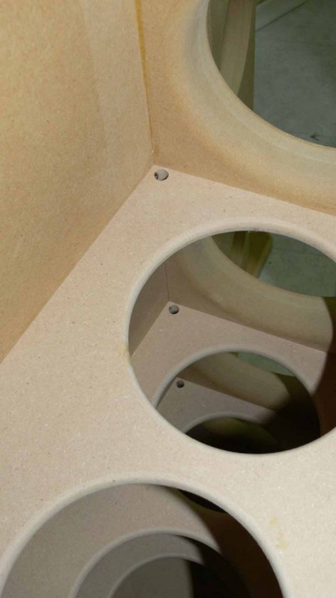

We have included  holes in the braces to pass the wiring thourgh which will be orientated to the  insde (full wing) of the cabinets.   C/O boards  that fit snuggly betweenthe no rez and screw to the top of the bases will have a  monting point for the tube connectors (they'll of course mirror each other  for left/right cabinet).
I used some cool little "rubber feet:" on the bottom of my amp boxes for my subs, trying  find a  place to get a bunch of them  so we can  throw 8 of them in  with the kits for the bottom of the  c/o boards

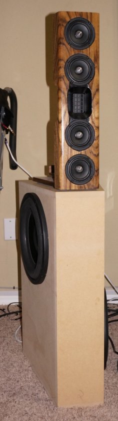

Aren't we not then at the same place as putting a bass unit under the Wedgie? Is it possible to DIY what you were contemplating as the bass unit for the Wedgie to go under the NX-Otica?
Josh
Josh,
Yes it will work. The original design is for use with three 8" drivers per side:
I modified it for two 12" drivers to fit the Wedgies. Wider and deeper but height is the same (plinth not on in this pic):
It will be easy to modify this 12" version to fit the wider NX-Otica or X-Otica. The front piece would need to be 1" wider than the front of the NX-Otica then the dimensions of the top, bottom and internal brace would need to be adjusted to fit. The 12" base units are 17-1/4" deep so the 14" deep NX-Otica will fit on top of the wider wedge without having to make any adjustments to the side panels.
By making the front piece 1" wider there will be 1/2" between the sides of the NX-Otica and the sides of the wedge base units.
Mike
