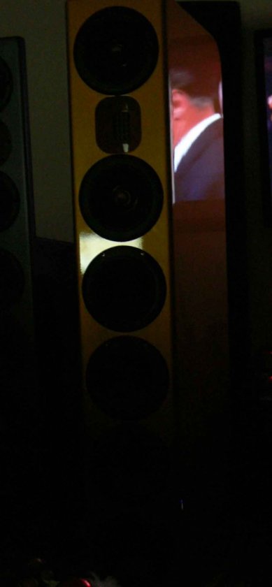

Nice looking finish Jay.
I haven't figured out how to get a camera to do justice to a speaker yet and that is after getting a decent DSLR.
Mike
I took the liberty to try and remove the colorcast. Hopefully, these are more true.
thanks jzexport
Both somewhat better, the top one looks closer than the bottom one.
Steve & Mike,  yeah,  I'm very happy, I wish I could do a better job withthe camera  to show them better.
One more I took when watching the tube late  last ngiht. compoter monitor behind was on too
jay
Mike
Built in flashes on cameras almost always suck when faced with shiny reflective surfaces. You don't necessarily need a DSLR, but do need something that shoots in low light which means large aperture/fast lens. That way you can shoot with ambient light and get away from all that glare.
Almost without exception the more recent photos I post here are shot without flash with a compact Panasonic LX7. I bought it specifically for it's ability to shoot in low light and wide angle capability which is needed for pics of remodels. I was tempted by the gadgetry and associated complexity of DSLR, but in the end I made the right choice for me. FWIW, it's capability certainly exceeds my ability to use all it's functionality.
I so want to hear these.
Peter, trust me, it's not the camera   :lol:
I've been using my Panasonic  FZ30, older than your  LX7 but at one point was the flaghsip.  It is capable  and if I actually took the time to  review /re-learn everything, you guys would all be seeing  much better pimages, unfortunately it's just not high on my priority list
I hear you  !!
jay
