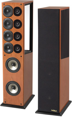

Dave - keep an eye out for used Nola's. A friend picked up a used pair of Nola KO's at 1/2 price - 90 dB sensitivity at 2.8 volts and an average 8 ohm impedance, they are full range, easy to drive and sound fantastic with an AVA 35 W/channel Ultravalve.

I wouldn't trade my Omegas for NOLAs. Heard them a few times at RMAF and they are not my thing...
