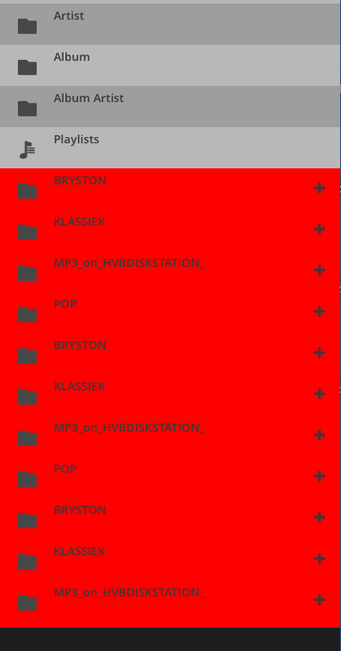

HI Chris,
Latest beta stopped the flickering completely! this is wonderful news, and so much better. Thanks for that.
Only thing now: I've updated the bdp1  but still all the red entries in the folder browser are displayed. Ive clicked the + many times now, they're still there.
what to do? Notice the double entries. (before i had some non  recognized files displayed there, could this be indicating the location of the files, instead of the files themselves?
Marius

  • Posts: 2067
    • bryston.com
Re: MM S2.10
« Reply #14 on: 24 Dec 2014, 02:45 am »
HI Chris,
Marius
I suspect those are old mount points that no longer contain music and will stay there until you turn the show missing folders and files feature off.  The fact it shows multiple times is a known issue, the function that displays the information is called multiple times.  I've never gotten it to occur consistently enough to properly troubleshoot the issue, as it's more of a Minor nuisance it's been pretty low on the priority list.
Cheers
Chris
