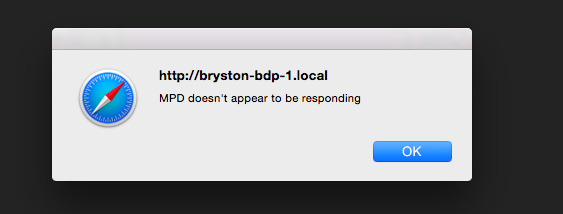

HI Chris,
Latest beta 01-12 broke my bdp1. It will load the initial MM interface, but immediately displays 'MPD appears not to be responding'. I can't get it to play anything, not through MM, Mpad or buttons on the frontpanel
 what to do?
servicemode (30) and please have a look?
Thks

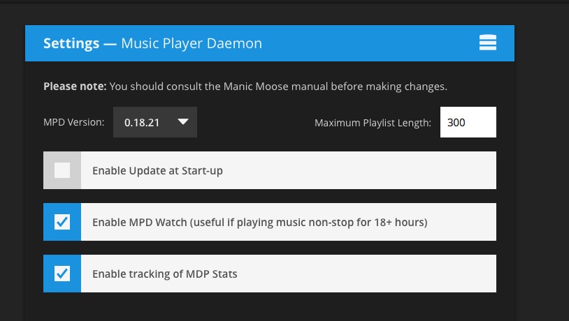

Marius
Re: MM S2.10

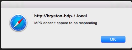

« Reply #29 on: 14 Feb 2015, 05:46 pm »
Maybe related to the mdp issue: after each update, i get the mpd  not responding error message.
On the services tab, MPD is not selected after updating, and selecting it does not show the tick in the box. It takes at least 3 minutes for the mpd to be available after ticking it.
And even then: the installing mpd message on the frontpanel is displayed.
Would be very user friendly to heave it dissappear when ready, or state so: BDP ready.
Marius
Sorry, I ripped out the root filesystem access; I'll see about enabling a developer mode of some kind to allow access.  I can't say I have witnessed the messaging stating up, usually it's cleared by MPD state change.
Marius

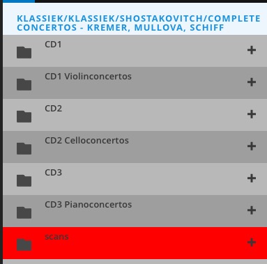

HI Chris,
renaming some folders and clicking the+ sing next to it does bring them up in the grey area, but it leaves the old folder names there too :scratch: is this a software glitch or expected behavior, forcing us to click the update button and updating the full database in case of folder renaming?
unnamed cd1 cd2 cd3 (old names) next to the new named folders.
Marius
unincognito
  • Posts: 2067
    • bryston.com
Re: MM S2.10
« Reply #37 on: 21 Feb 2015, 05:27 pm »
HI Chris,
Marius
That'll require a global update of the database
