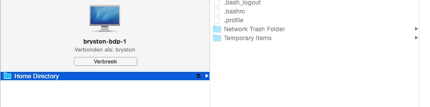

Cant connect the finder anymore to my usb drives on the BDP1, this it what happens:
Any suggestions please ?

Still there with version S2.11 2015-03-24. Mac finder shows a Homedirectory, where it previously showed the attached usb drives and Root. Need those for transferring files....
btw, the News on Settings/System
still shows an empty page, both on Safari and Chrome.

HI chris,
Please have a look at this?
Marius
have you tried the connect to option found under the go menu?
Marius
Re: MM S2.10
« Reply #52 on: 30 Mar 2015, 04:51 pm »
Yes I have and that works most of the time . Still the newly found 'home directory' in Finder is of no use and I deerly miss the Bdp in Finder as before.

« Reply #53 on: 30 Mar 2015, 09:21 pm »
Marius
havn't had a chance to test it yet, but i think that due to the new apple talk daemon installed to restore AFP client support.  Should be resolved in the next update

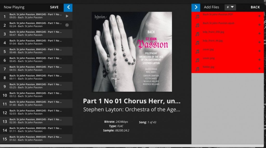

The strangest thing: in MM the individual tracks of this recording are not displayed in the file-list to the right, the non music files are (in red). The files are there in Mpod, and also available through the front panel. Ive selected the top folder and pressed play in this case. See the playlist being populated.
Never had this before in any recording. what could be done?

The strangest thing: in MM the individual tracks of this recording not displayed in the file-list to the right, the non music files are (in red). The files are there in Mpod, and also available through the front panel. Ive selected the top folder and pressed play in this case. See the playlist being populated.
Marius
Perhaps something in the path is causing the list content program to crash?  Could check /var/log/apache/error
Looking for errors generated by
/var/www/mpd/library2.php
Cheers
Chris

wish i could.... it only connects to the aforementioned Homedirectory, even through the finder menu 'go/connect to server'..
Cheers
