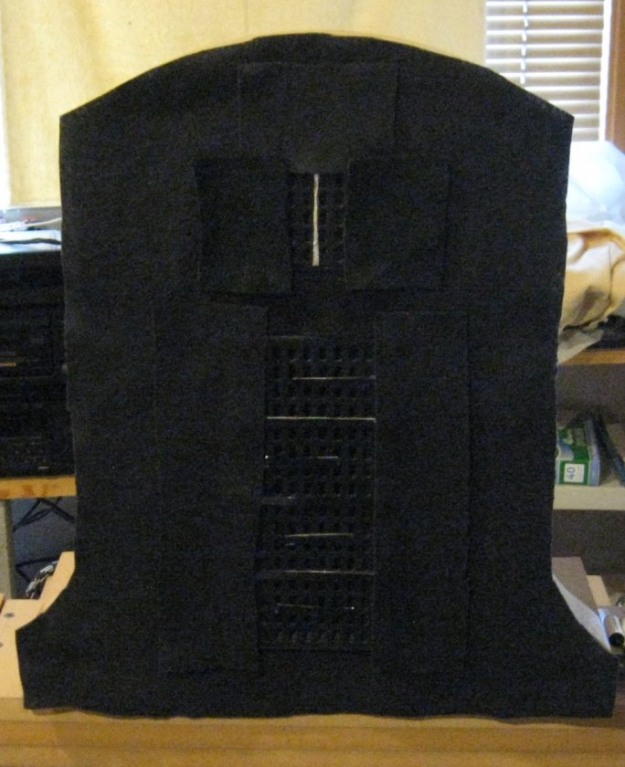

Re: Neo 3 PDRw vs the Neo 3w
« Reply #6 on: 29 Nov 2014, 10:07 pm »
Ric,
that is the same set up I am leaning towards. I understand that a 12" wide baffle works well.
Do you think that two layers of MDF is sufficient, or is it better to have three ?
I can't tell by the pic, but are all of your drivers flush with the "front" of the baffle ?
(the pic shows up very dark on my android screen, can not see much detail, my android screen is poor.)
thanks.....

Yes, the drivers are inset (flush with panel).  This does not matter as long as you felt.  I like the "idea" thick dead baffles, so I start with 3 layers.  Very, very few have played with baffle types that have any useful information.  I would think that a baffle would be best if it is dead and multi-resonant.  Like bamboo for the front layer, then highly refined MDF for the middle layer and birch plywood for the back layer.  This way all three layers have a different resonance.....and all three are already more dead than regular MDF.  The thicker baffle will slightly help the low frequency extension, as well.
