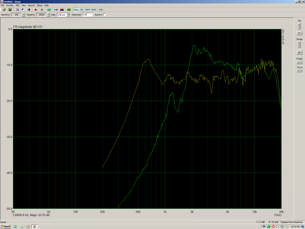

For reference, here's a measurement of a Neo3 tweeter with and without the back cup installed.
This is a totally un-smoothed measurement with my microphone 1" from the driver face and the drivers mounted on a piece of plywood that's large enough to be an infinite baffle for this frequency range.
The relative differences should be pretty easy to see.  :)
(It might be a little hard to see, but the large amplitude divisions are in 10db increments.)
I appreciate that some users will be planning on crossing over this driver above the lower portion of this range, but you still have to be careful using lower-order filters.
I hope that helps to visualize the performance of this tweeter for those interested.  It's a good tweeter, but you simply can't treat it the same with or without the back cup installed.

That's a Neo3 driver....and it's actually the same driver.  Initially tested with the back on and then with the back off.  The measurement setup is identical in every aspect except for the missing rear chamber.
It might look like a jagged mess upon first glance, but look closely.....there's much to be gleaned/learned from those response curves.
The relative amplitude response difference can easily be addressed when incorporating into the final design, but take notice of some of the other factors as well.
Close up measurements like these reveal much information about a driver.  (Information that wouldn't be seen with a 1-meter or listening position measurement.)
Keep in mind there's increased distortion associated with the un-chambered configuration.......even if both were equalized to identical amplitude responses.

Will be interesting to compare this set of measurements with the NEO3PDRW version at 1" from the face.
If somebody has a spare one, send it to me and I'll test with the identical configuration.
I would expect to not see much relative difference (other than an amplitude offset) with an on-axis measurement since the PDR version is optimized for wider/better off-axis response.

It is very simple baffle loading for the Neo3 family. The back cup damps the motion of the diaphragm and prevents dipole cancellation. The wide baffle, wings and waveguides prevent the dipole cancellation on one or both sides and alters the FR..
Measuring the dipole in the open is informative, in a box (cup) is useful to indicate how far down it could go given enough baffle/wings/horn or waveguide.
listening tells you immediately that the dipole setup is far more transparent and conveys more detail. Magical nearly like a true ribbon, just much tougher and rugged. Then stick it in the kind of baffle (with waveguide, wing or horn, or without) you would use in reality and measure it then. That would be the actual useful measurement. It comes out much flatter than the open air measurement and extends nearly as far down as the measurement with the cup given enough baffle. The baffle retains the magic of the dipole driver while the back cup makes it sound like a good dome tweeter, precise dry boring without the delicate rendition. The cup just adds a new family of resonances while reducing the diaphragm resonance frequency peak by internal cancellation.

Quote from: satie
Measuring the dipole in the open is informative, in a box (cup) is useful to indicate how far down it could go given enough baffle/wings/horn or waveguide...
Quote from: davey
Funny how two people can read the same words and interpret the results completely differently.
Considering this tweeter was never designed to operate w/o a cup on the back, it does pretty okay if it's used within a range where it's not being over driven (> 4kHz), the crossover is steep enough (3rd order or better) and the crossover network properly compensates for the rising response before its rapid roll-off (especially if it's horn loaded).  IME.
