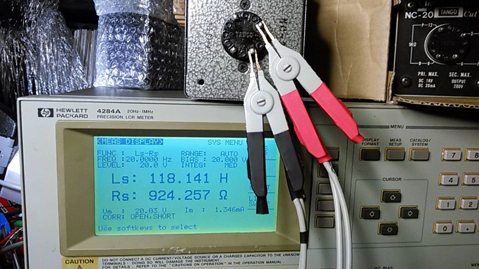

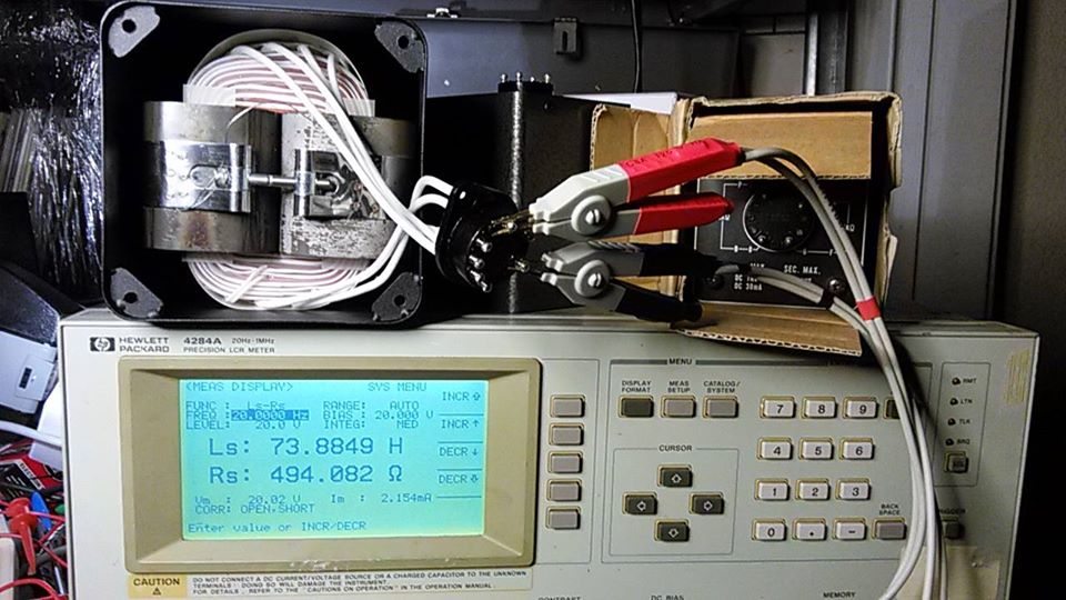

Tango X10S Inductance

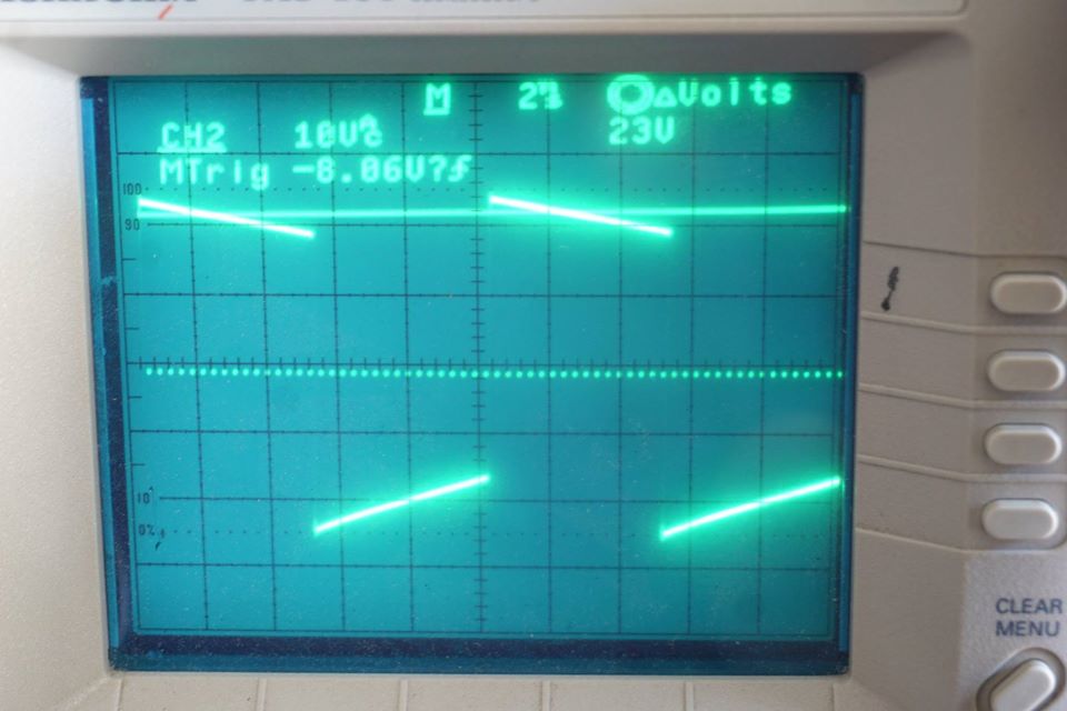

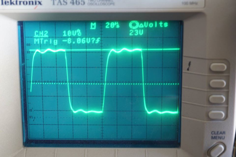

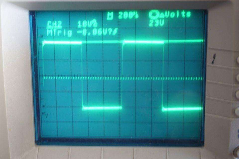

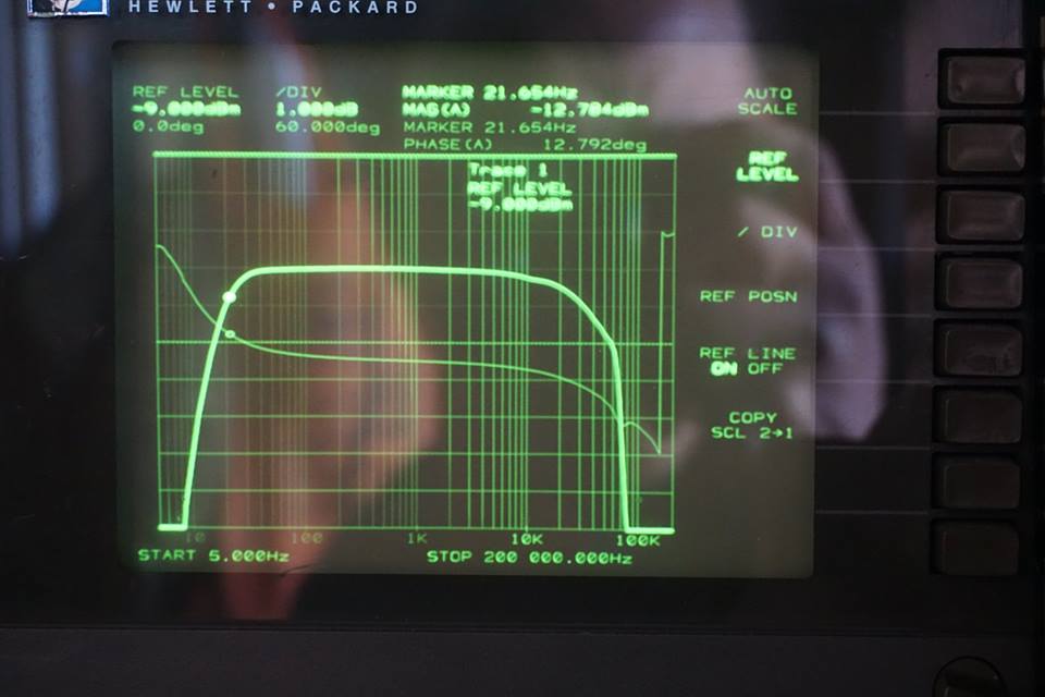

GM70 amp, Tango xformer in action X10S/NC20/845 in action, @ full power 30W freq response.

Tango NC20 Inductance.

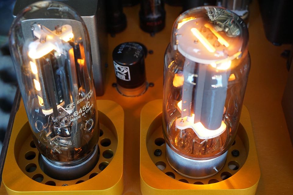

Lundahl transformer upgrade for Eleket TU8600R 300B SET.
0609201205_HDR by drjlo2, on Flickr
Oh man I am jealous!
