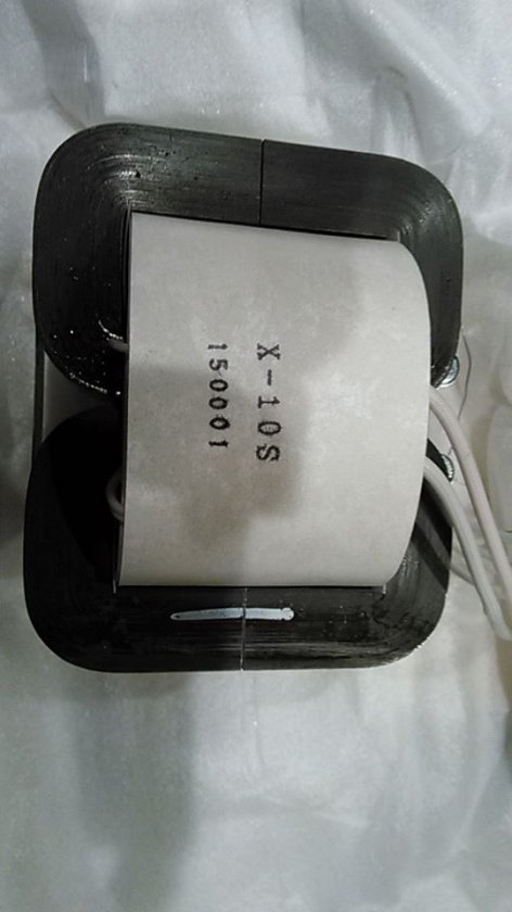

This is what TANGO X10S core look like before being potted.

E55L2,
What is this transformer?
EI, C core, choke ?
