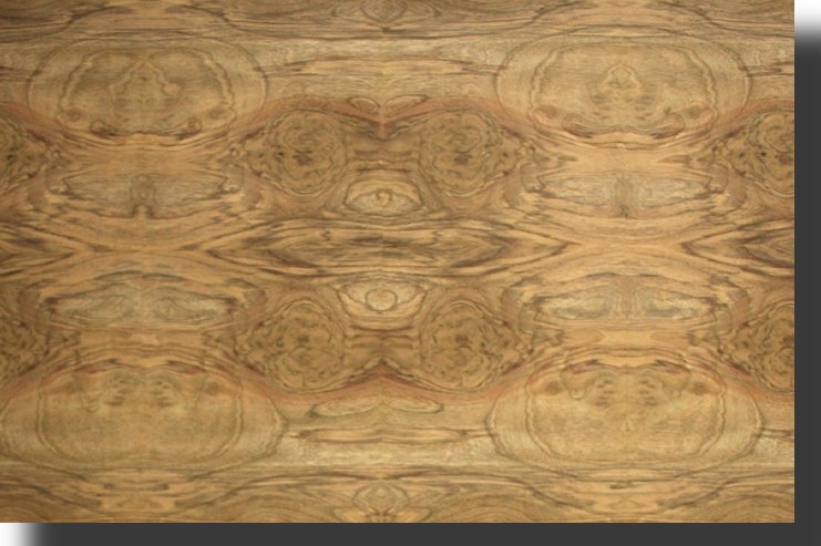

I think the working assumption is that the waveguide portion would be painted, and veneer would be applied to the surface. The wg is a straight 45° without a radius to the baffle surface, so a transition here wouldn't be too difficult.

That wave guide is going to make veneering very tough.  I don't know if you could use a softener to get the veneer compliant enough to make that work or not.  Even if you did, the grain patterns would be incredibly tough to get to match.  Maybe a veneering pro will offer up some ideas.
Yep, my plan is to ebanize the inside of the waveguide and driver cutouts using India ink. Then veneer the rest.  Since it is open I am going to have to veneer both sides of all panels. I'll probably have to do the veneering before glue up at least for the baffle. Which will mean protecting the veneer from glue contact during glule up.
Why chase the ghost. Just make it out of Baltic and stain it.  Work smarter not harder
I found some killer walnut burl veneer I'd like to use on these
Mike

The guide could be painted, and the baffle veneered right up to it's edge.
Oops, already suggested :duh:.

I'm thinking the insides are going to have to be veneered before glue up with the veneer protected from squeeze out by a coat of shellack and/or painter's tape. The shellack protective coat would be sanded back down to bare wood after glue up for finishing.
With the outside corners being rounded over, they will need to be veneered after glue up.
Mike
