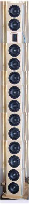

Danny, you certainly know how to keep a would-be speaker builder in suspense  :lol:.  Looking forward to the flat-pack and final pricing information and availability.
In the mean time, does the bottom need to be solid on the MMTMM?  I am assuming so since this is apparently the configuration in which you tested it.
What will be the optimum height for this speaker, NEO 3 at ear level, higher than ear level, any tilt required?
Ed
I sent the test baffle to Ben for him to look at it and quote the CNC'ed flat pack. He has done a great job with all the others so far. So I am waiting on that.
There will need to be a floor below the bottom woofer. It will be just right for mounting the crossover in there.
Optimal tweeter height is usually in the 38" range. Plus or minus a few inches is fine and the real optimal can vary depending on the seated height of the listener.

The 9 LGK below the MMTMM should lower the distortion on the MMTMM array. Looking forward to see the pricing for the kits and the flat packs.
mlundy57
  • Posts: 3640
Re: Something new that sounds incredible
« Reply #186 on: 12 Jun 2014, 06:15 pm »
What distortion?  I was under the impression the MMTMM was clean and articulate without any distortion. Especially when Danny compared it with the Super 7 and LSX when paired with 12" OB servo subs.
ebag4
« Reply #187 on: 12 Jun 2014, 06:19 pm »
If I understand correctly the 9 LGKs below the MMTMM are actually going to be used as woofers covering ~150-200Hz where the MMTMM takes over from 200Hz and up.
From Danny:
The 9 LGK's below should hit 94db levels. But the range will be limited each way, so it may work out well. The woofers in the MMTMM will roll into them and the subs being used will roll into them on the other side. I think it will work out pretty well. It will all be in how I design the crossover and how the high pass is handled to those drivers.

How about the
TM
TM
TM
TM
TM
TM
TM
TM
TM
TM
TM
TM
TM
TM
TM
TM
... or maybe you could just call those a Pipedream because nobody would ever build that thing.
