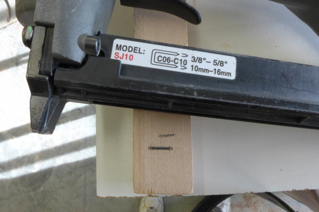

 Link didn't get me there, but T-50 is a pretty good sized staple. Gun I have is Senco SJ10, and contrary to what that label says it will shoot 3/16 leg. I may have put another driver in...had it for years.
Bigger staple in photo is T-50
