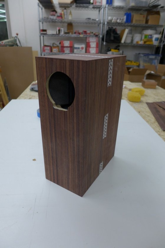

Peter,
What is the dark stuff on the corners?
Mike

Been out of town, got some more licks in today.
Here's a couple of teasers
It looks like you camphored the edges after the veneer was applied. Is that correct?
Mike

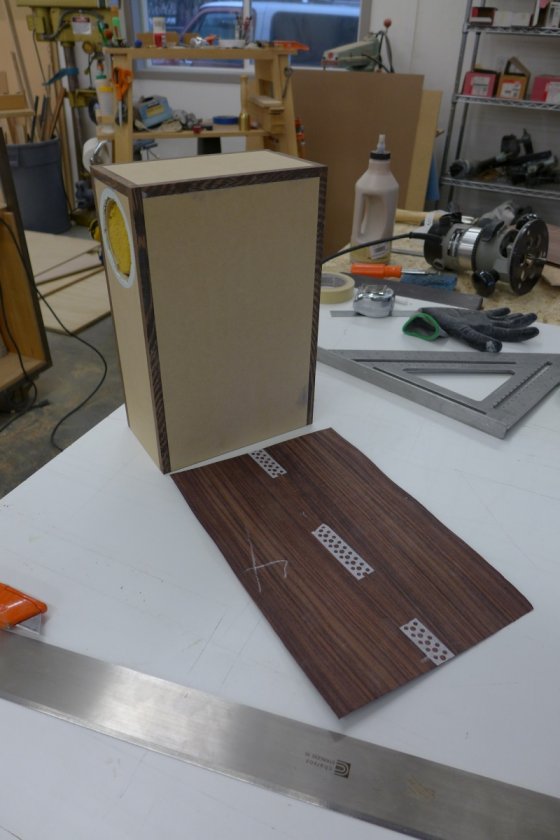

« Reply #82 on: 12 Apr 2014, 08:17 pm »
Right you are Mike.
 I glued in 3/8 x 3/8 strips of Wenge in first photo, then veneered box in what I think is rosewood (long story), and then chamfered vertical edges and top. The black and white photo shows them with a first seal coat of shellac. From here, I'll use grain filler, several coats of high build catalyzed sealer and finish up with pre-cat lacquer. Should be a really nice finish.

Right you are Mike.
Peter,
If you were going to chamfer the edges, what was the purpose of the Wenge strips? Didn't the champfer cut through the strips?
Mike

I was wondering the exact same thing.... maybe a guede for putting onthe  "main" veneer" so it would line up  perfectly with  a 3/8" chamfer with out having to  cut through the  veneer and risk chipping ?
-jay

« Reply #86 on: 12 Apr 2014, 11:31 pm »
When I chamfer the edges it exposes the wenge. Makes sort of a frame for the rosewood. Sharp bit, climb cutting and masking tape keeps veneer from chipping.
Unfortunately, I just screwed these up in a big way. I used a water based grain filler for the first time. Should've experimented on something besides the finished product. Finish coats show all kinds of blotching and uneven color, I'll have to tone the cabs heavily with dye to blend it all which will mostly obliterate the grain.
Live and learn... should've stuck with what I know. Guess that gives me an excuse to build another pair of perhaps five for a mini home theater...

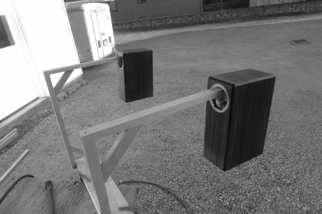

As mentioned above, I goofed up. Once I saw that I was way off track from what I was shooting for, I necessarily went a different direction. I guess it's a lesson I needed to relearn...
Not awful, but not what they could be.

Very nice Peter.  I think they look  great  :thumb:
-jay

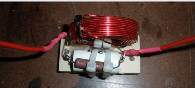

My second thing is (to any and all experienced hands):
Okay. I've got the coil, cap, and inductor snugly attached to a piece of board with zip ties and silicone glue. I know they will be attached (screwed to) the back walls behind the drivers, but...
Correct me if I am wrong in my assumption:
I attach the red wire from the amp to one side of the filter and the white wire to the other side. Another red wire will lead from the filter/amp wire connection to one of the driver connections; ditto with a white wire. Does it matter if I attach the red wire to either driver connection?  I mean is there a right way and a catastrophic way? So long as there is a circuit does it matter which direction the electrons are flowing?
[I just attached speaker wires to the filter and the included red and white wires to a driver. Success! I got music.  :D I got music even if I switched polarity, but I want to think only one connection was correct and reversing polarity may damage the driver??? (Yes/No?)]
I hope I haven't confused you horribly just now. Thanks for the hand holding.

Michael,
Maybe I am misreading you and this is what you did. I understood the connection as follows (leaving the terminals/Electra Tubes out of the equation for simplicity):
Amp Positive ---> 1 side of filter nework
Other side of the filter network --> Driver Positive terminal
Amp Negative -----> Driver Negative terminal
In other words, the negative side of the amp and negative side of driver will never touch the filter network.

Mlundy on the page back posted this:
Just like baniels says:
Then white to white (negative to negative on driver)
