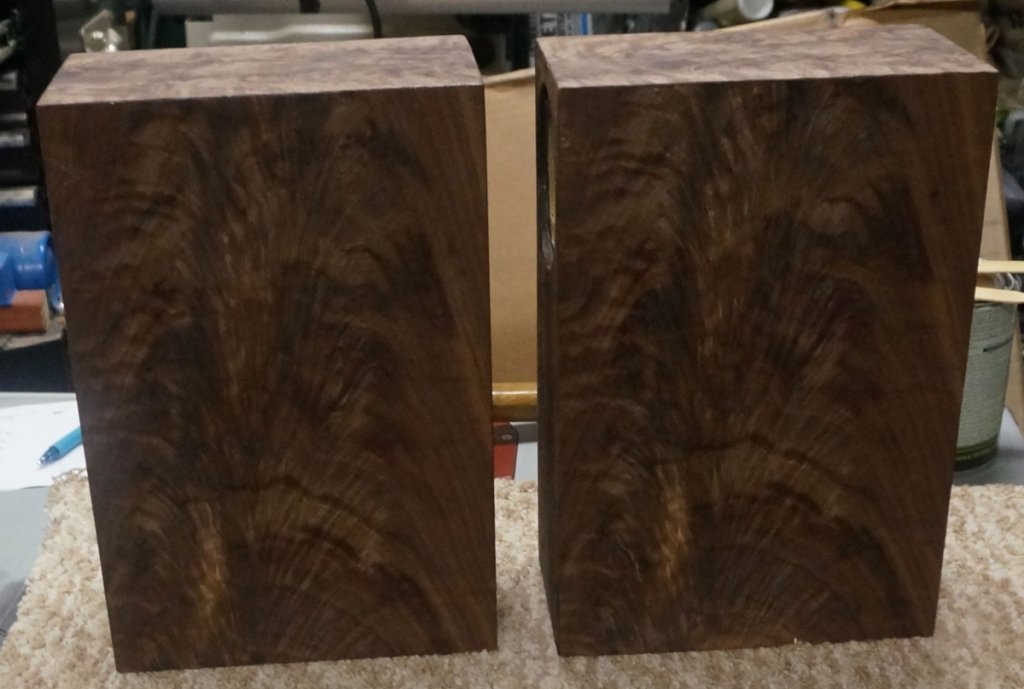

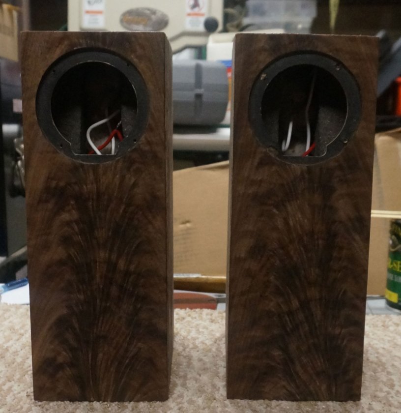

One nice thing about the size of these speakers is that they are small enough you don't need a lot of veneer. This means you can find some really good closeout deals on some pretty exotic veneer. I was able to find some crotch walnut raw wood veneer in large enough pieces to cover each side in a single piece and keep the best parts of the figure.
I really liked the three dimensional texture of this veneer so I intentionally left the wood rough, not sanded smooth. Because of this, they do not have any gloss to them even though they have three coats of poly.

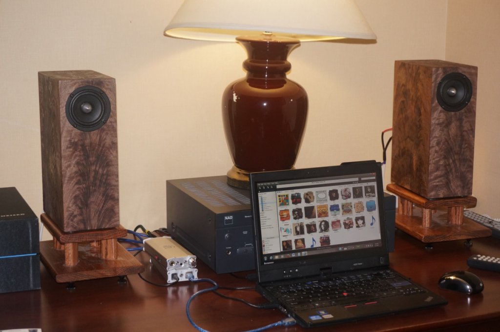

How easy was it to replace the promedia speakers? I'd be interested in hearing the details of the mod. I've skimmed through some of the reviews of the promedia 2.1 online and it sounds like a system with a lot of potential with the mods you're speaking of..
I wouldn't call it a "mod" by any stretch. I was in a pinch and my OCD took over and I started looking for something that they would fit it.
Four screws and the from plate of the ProMedia pods come off with the speakers attached. I disconnected the tweeter replace the woofer and screwed them back together. By no means is it optimal but they still sound fantastic.
