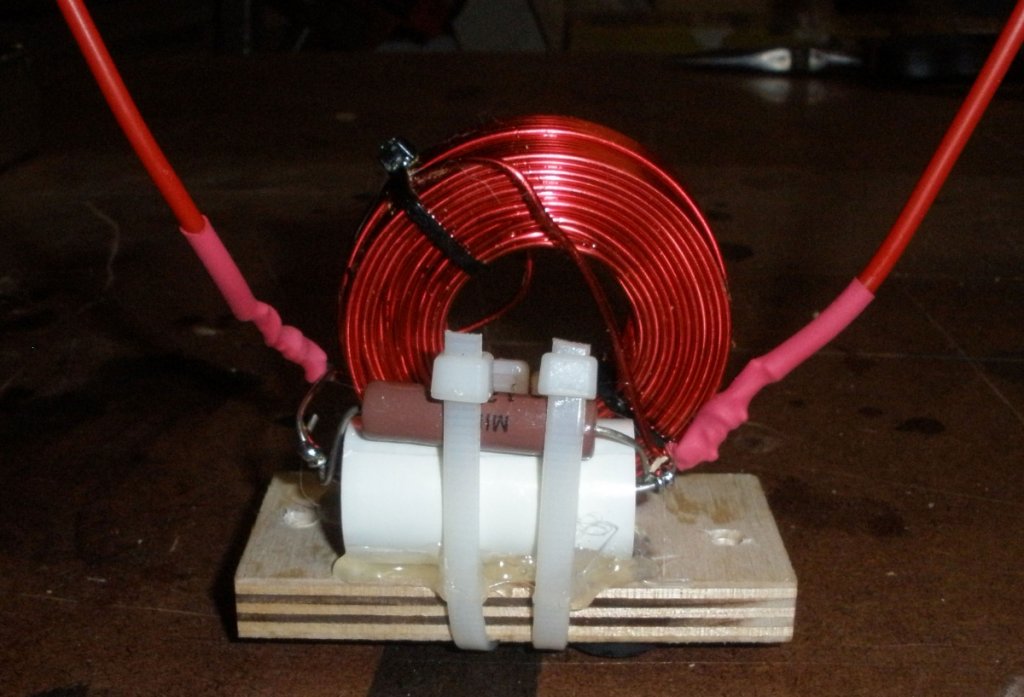

Noob question:
I understand that the coil/cap can be mounted on a small board, which is then glued/screwed to the back wall of the speaker behind the driver, but how to I wire the the various components to the small board in the first place? (no experience). Has anyone got a clear picture of an assembled unit?  :(
Danny Richie
Re: LGK 1.0 are here
« Reply #72 on: 7 Apr 2014, 08:56 pm »
Noob question:
Stand the coil up on its edge just like the one in the upper right hand corner of this pic.
Zip tie the inductor to the board and hot glue it or Silicone it to the board as well.
Attach the cap and resistor to the side of it with zip ties.
Drill some holes in the corners of the board for screws that can attach it to the back wall.

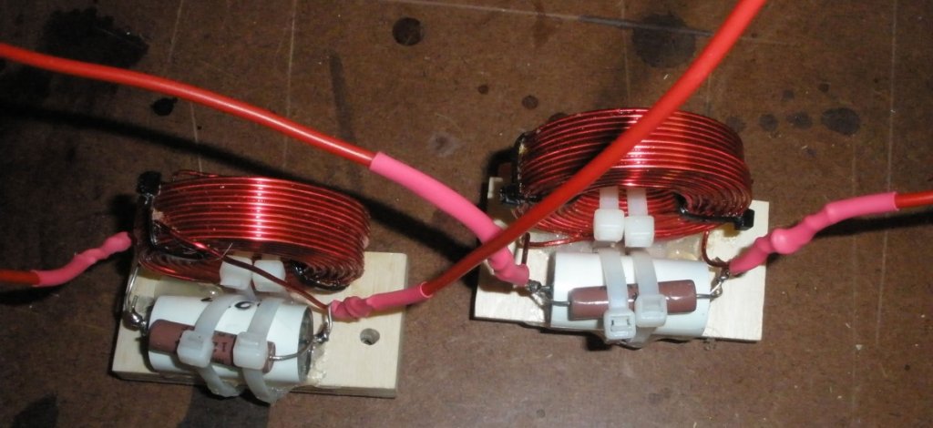

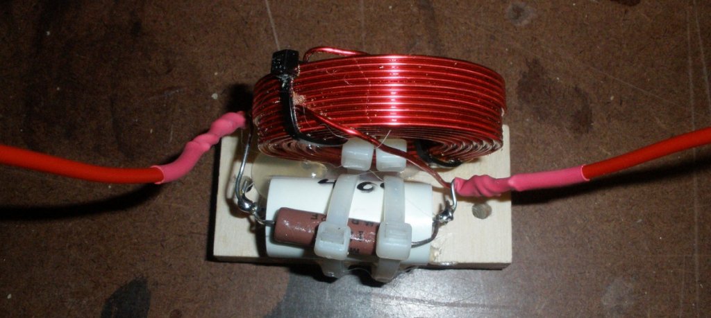

« Reply #73 on: 7 Apr 2014, 09:19 pm »
And all three components are wires in parallel, correct?
mlundy57
  • Posts: 3643
« Reply #74 on: 7 Apr 2014, 09:33 pm »
Here's how I put mine together
Mike
Danny Richie
« Reply #75 on: 7 Apr 2014, 10:09 pm »
Yep, just like that.

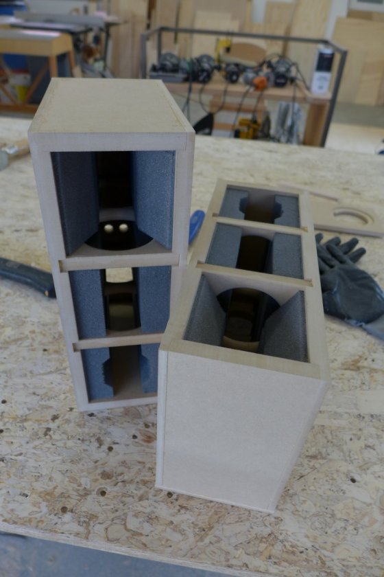

Two LGK 1.0 noobs walk into a bar and order drinks. The first one says to the other: So far my only mistake is the internal braces in one speaker aren't exactly aligned (holes are offset rather than exactly aligned) even though I had written an F and an R so as to avoid making this mistake.  :duh: The 2nd noob says to the first: Well, my mistake was to cut the No Rez 7.25 inches long (instead of 7") and I didn't discover my mistake until after I had pressed the sheet down hard onto the inside of the speaker.   :slap:  Luckily, I was able to cut the excess away without damaging the cabinet.

« Reply #79 on: 12 Apr 2014, 01:50 am »
Been out of town, got some more licks in today.
Here's a couple of teasers
