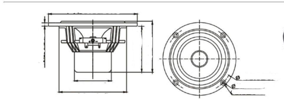

Danny,
Could you provide these dimensions if possible.  Need to cut some wood.... Or at lease the numbers that matter to cut holes and sub sets.
JP
I'd add a bit to that recess number.  Instead of .12 I'd make it .15m (3/32). I find that my LGK is protruding just a touch over the cabinet.  I always like to make the recess a bit deeper... if I get too deep I can always cut some thick paper/card stock to act as a shim.
Danny Richie
Re: LGK 1.0 are here
« Reply #42 on: 26 Mar 2014, 03:50 pm »
JP
The gaskets that they put on the production models are slightly thicker than anticipated too. So if painting or veneering I recommend pre-fitting the drivers to double check your depth.
