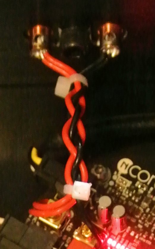

Here's what I did to wire the speaker outputs from the nCore 400.  I just braided some wires.  Length about 2"
You have a bit of what I warned about - too much distance between the wires from the output posts until the braiding kicks in. Ideally the wires should both be starting out heading inwards.

Further, the wires need to come out of the NC400 from the same side of the terminals.  So looking at your picture the black wire on the right needs to be moved to the left.  This is per Bruno.

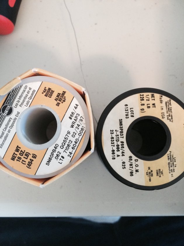

Kester Solder is all one needs.  Here is a small sample of what the packaging looks like.  I have many spools!  If you feel the need they have Silver Solder which is what all these other companies buy and resell.
