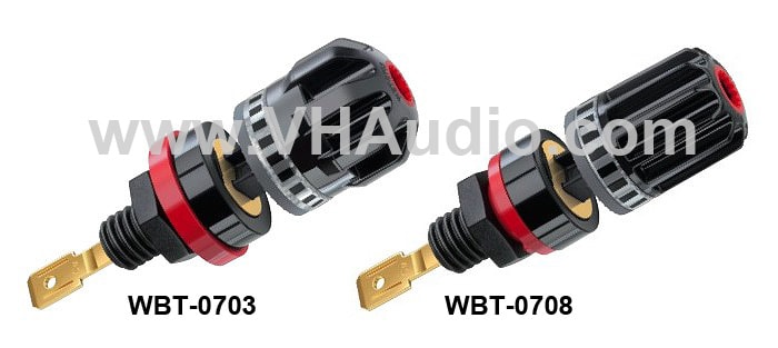

Next question is what is the best way to terminate on these binding posts? Do I just wrap the speaker wire through the hole and then put a blob of solder on?
