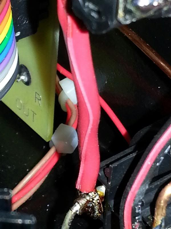

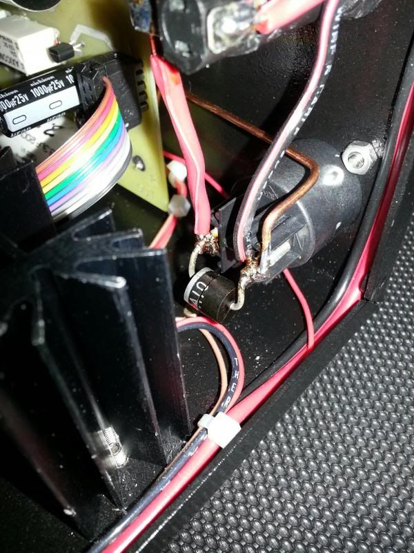

I borrowed the battery from my preamp for another project and forgot to write down how the battery was connected.  Well I switched the cables around and I blew something  :oops: .  Initially I thought it was the fuse but than I saw smoke coming out of the preamp and when I opened it I saw that cap below the battery connection was split in 2.  Anyone have any idea on what is required for me to fix it?  I also saw that one of the wires going to the fuse has started to melt.

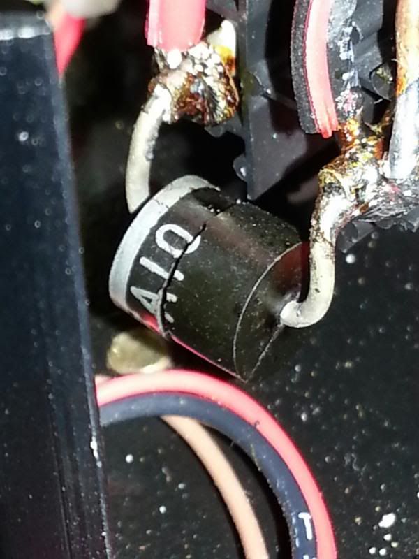

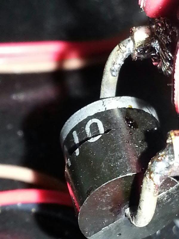

Looks like a limiting reverse biased (Zener?) diode to me, not a cap. But I could be mistaken. Get all the characters on the part and search it. You'll find out what it was.

Thanks. Will try to solder it off and see what it is.

Look like you had it the battery polarity wrong.
Just cut off the diode and it should work but you don't have the protection anymore.

Yep, I did the same thing, so you aren't the only careless one around here.  Just be careful with polarity with no protection after you cut it out.

Don't worry man. That diode is there to protect the pre-amp when you get your battery polarity flipped. It did it's job, and your pre-amp is fine.
That Gary Dodd is a pretty smart fellow.
And don't feel bad. I'd done it too.
