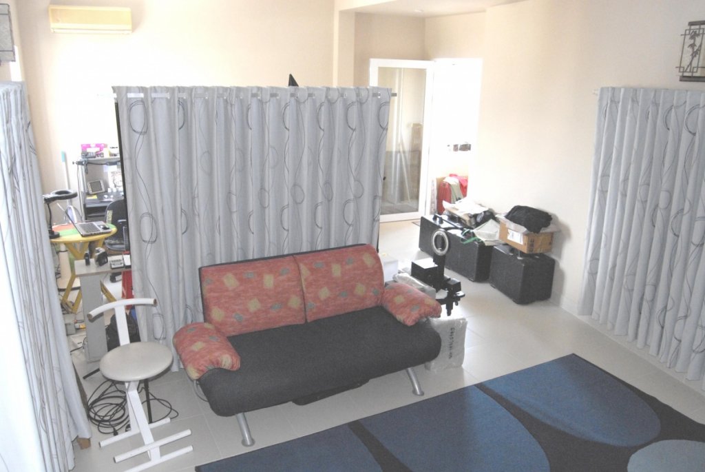

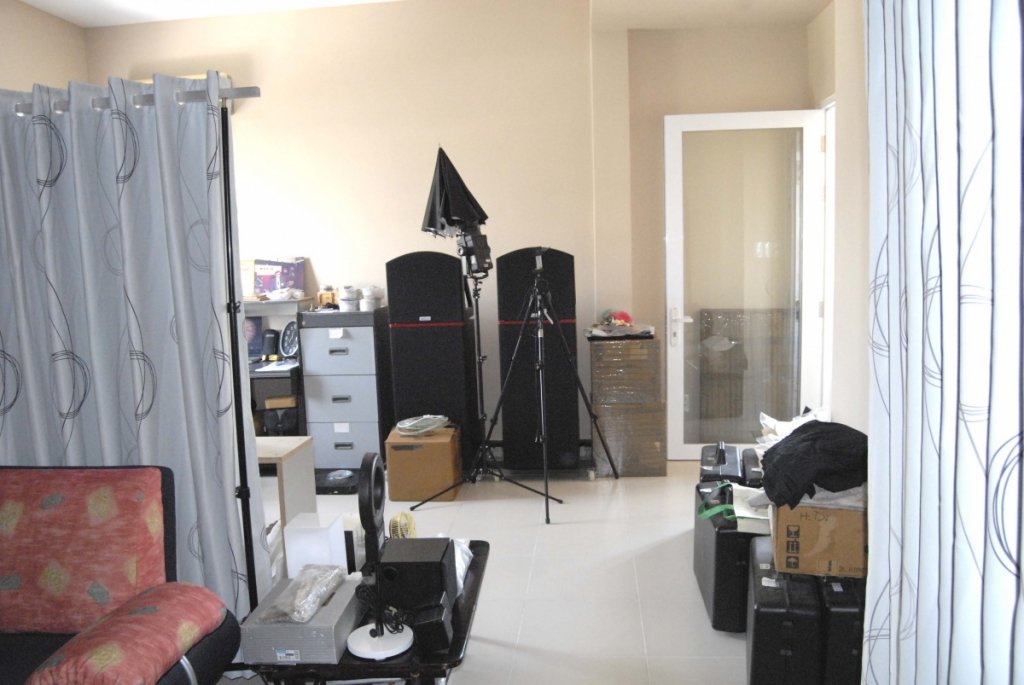

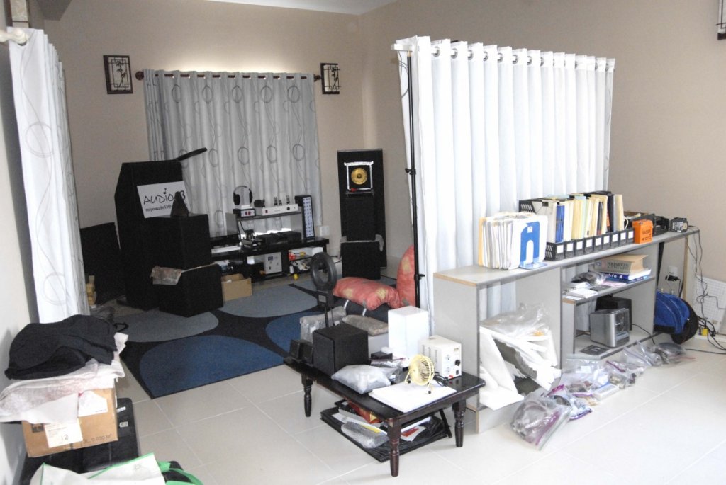

My listening room is 12.5’ wide at the front and 14’ wide at the back,
13’ long and 10’ high.
The whole room is armored concrete with a ceramic tiles floor.
My first improvement was to install curtains in the window behind the OB speakers; it acts as absorber and maybe diffuser, since it as ripple in them.
The curtains on each sides is at the first reflection point, again they act as absorber and diffuser, well maybe not very efficient, but better than nothing for the time being.
The back wall, well, there is not back wall, only curtain that again act as diffuser and absorber and at the same time, a separation between the listening room and my office, it also makes my listening room smaller for near field listening.
The ceiling is naked and the floor is covered with a rug, later on I will buy a thick under rug , when I can find a store that sell them, because I have found many stores that sell rugs, but no one offer the under rug (Undercushion)…
Now, bass traps.
I know I need one in each corner, but I only have two real corners,
the other two corners are small and large openings.
Maybe I could block the small opening with an absorber
and partially block the large opening with another absorber.
For the ceiling I will need a minimum of two absorbers 2’ X 4’,
I will have to hang them, which means drilling in armored concrete, I hate that…
The two front bass traps will be 4” to 6” thick by 24” wide by 8’ high.
The back bass traps (Or absorbers, whatever you want to call them) will be 2” to 4” by 24” X 6’ self standing.
I am not sure about the diffuser on the front and back walls.
I would like to do them myself, factory built diffusers are expensive to purchase and costly to ship because I am on the other side of the planet.
I found an audio store that sell Styrofoam diffusers, but they are expensive
at 25 USD each for 24” X 24” tile.
Can I get away without diffusers?
According to what I read, you can get away with diffusers
if your room is small, is my room consider small?
Now, my budget is no more than 500 USD.
Cannot do much with only five Benjamin, even if I do it myself.

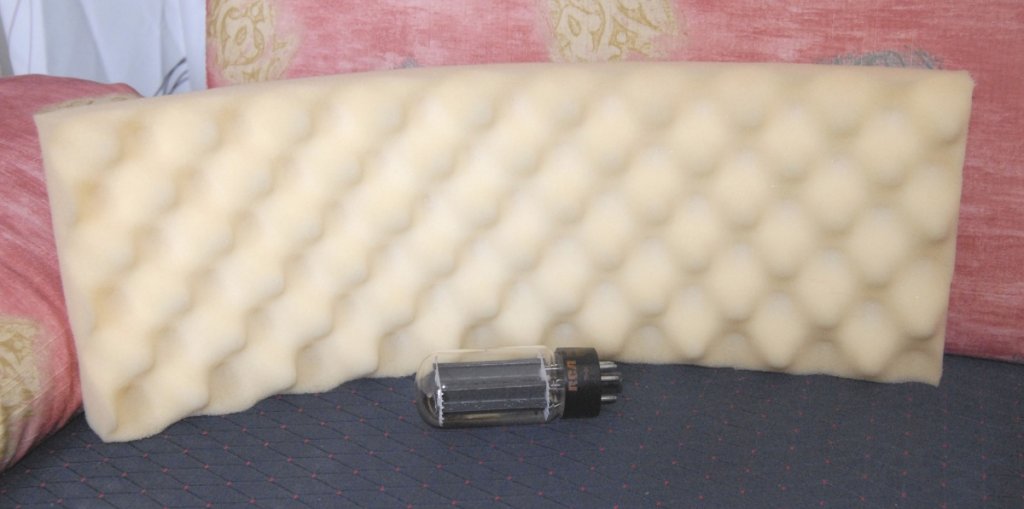

I was wondering if the pieces of foam shown in the pictures are of any use?
I could use them for the wall – ceiling junction.
I want to buy Roxul bat (2x4’) at 36 USD for 6pk, but I will have to inquire
about the cost of air cargo or sea cargo.
I have calculate that I would need 4 boxes of 6 bat each for a total of 144 USD + transport which will cost as much as the product themselves.
That’s where I am now.
Any (Inexpensive) ideas ? ? ?

Forget about styrofoam, foam rubber, or the curtains (all are acoustically useless).  Besides unless your room is a really awkward shape (cube for instance) the bigger the room the better.
Are you able to measure the in-room frequency response of your system?  (To solve a problem you must define it first.)  Do you have a microphone?  (I'm sure you can find test tones.)  How do you know how much ceiling absorption you need?
Nearfield setup will eliminate much of the room issues and it's free to try.
Search the net my friend.  The GIK website would be a good place to start to learn about absorption.
Find out what materials absorb at lower frequencies so you can get a balanced effect.  The best absorber is high density fiberglass (1 - 4 inch thick sheets).  Owens-Corning 703 I believe is the material, but being in Vietnam you'll have to find an equivalent.  Roxul looks OK, but not as good as 703 at lower frequencies and weighs only slightly less.  I'd mentioned tightly packed rolls of fiberglass insulation, it that's not available what else is that could be similar?
Diffusors that are sized for room use are only effective down to about 1,000 Hz and must be made of sonically impenetrable material (like wood) in order to work.  DIY recipes exist based on the math involved for the frequencies of concern (again what frequencies are a problem?).

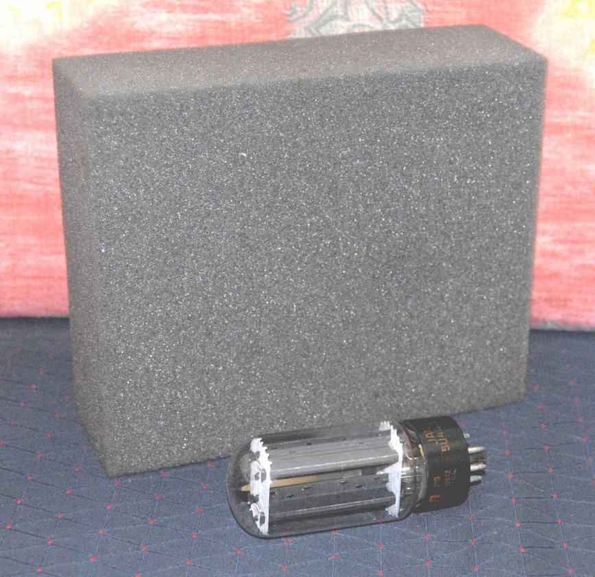

JLM is right on the money. Even 'good' foam isn't worth much. The foam you're showing is likely closed-cell which as pretty much zero acoustic value. Only open-cell foam has some benefit, though not much.
3lb rigid fiberglass board is what you want or as close as you can get.  Mineral wool is another option that works well and can be slightly less expensive. I just don't know what is used there for building insulation.
Bryan
